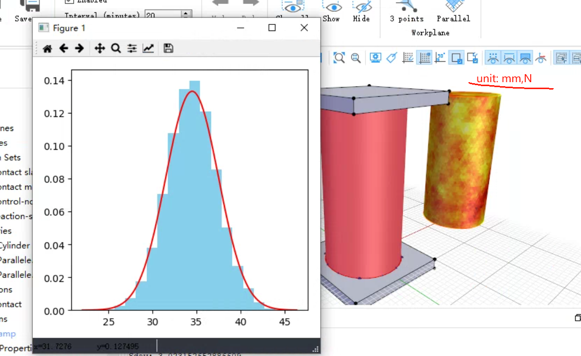

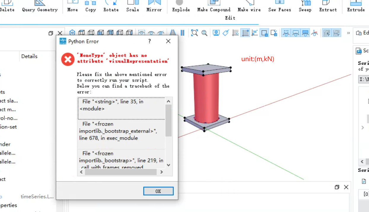

I hope this email finds you well. First and foremost, I would like to express my sincere gratitude for providing the GaussRandMat method. It has been immensely helpful in my research on material anisotropy.
However, I have encountered a challenge related to the original model dimensions. The provided dimensions are in millimeters (mm) and Newtons (N). When I attempted to convert the model dimensions to meters (M), I encountered issues with the Python file. Despite my efforts to modify it, the problem persists.
Would it be possible for someone to assist me in modifying the Python file to use units of meters (m) and kilonewtons (kN)?
Thank you in advance for your help. I truly appreciate your support.

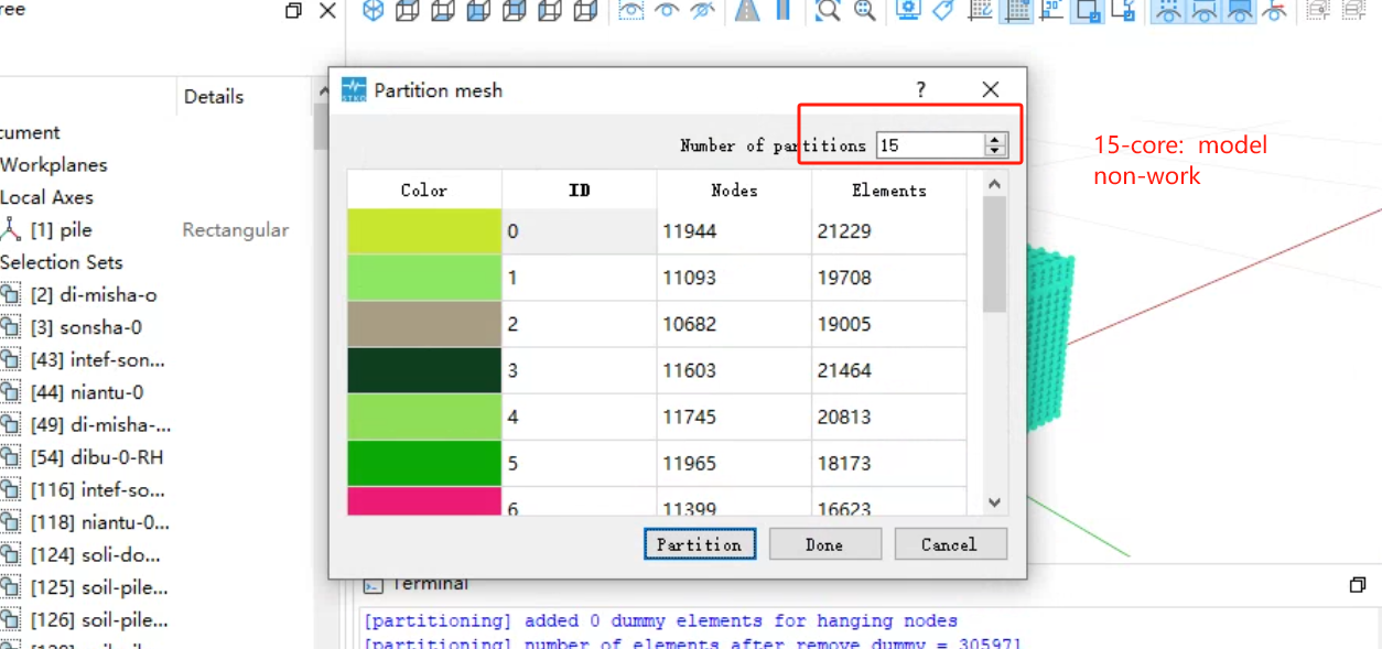

I would like to extend my gratitude for the damage materials you have provided, which have been instrumental in my research on structural damage.
I am writing to inquire about the availability of the ASDConcrete1D material. I have encountered an issue where the DamageTC1D material does not work on Linux systems. Could you please inform me when the ASDConcrete1D material will be available? Additionally, if possible, could you share the code or provide a link to the material on GitHub?

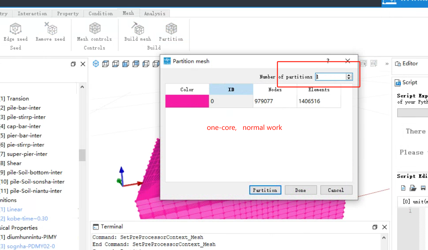

Furthermore, I am currently engaged in a soil-structure interaction study and have come across a problem while analyzing structural damage and failure. The model runs smoothly when using single-core computation (OpenSeesMP-Parallel-one-core section), but I encounter difficulties with multi-core computation (OpenSeesMP-Parallel-Multi-core section). In the model, the soil mesh is coarse with a grid size ranging from 0.1 to 0.2, while the structure employs a finer mesh with a grid size between 0.01 and 0.02. Despite my attempts to partition the grid across different cores, the issue persists. I suspect it might be related to the software’s parallel computing grid partitioning. Would you be able to assist me in modifying the model to address this problem?
We sent you an e-mail with the modified file.
Thank you for your time and assistance.
Best regards
Monace.Pasoke

Re: Python File Modification for Units (mm, kN)
I think you shared the files in N/mm.

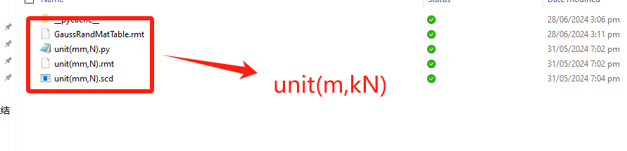

I am currently working on Course 30, "Understanding the Problem of Strain-localization and Fracture-energy Regularization," and I've encountered an issue that I hope you can help me resolve. The Python code provided on the official website is designed for model dimensions in N and mm units. However, my research model uses kN and m units.
If it would be possible to provide a new Python file based on the original one, but adapted for the metric system (M) units (kN, m)? This would greatly facilitate my work and ensure compatibility with my model's dimensions.
To assist you in understanding my request, I have attached the original Python code for the (N, mm) unit system from the official website. I would be grateful if you could provide a modified version of this code that works with the (kN, m) unit system.
Thank you once again for your time
Best regards,
Monace.Pasoke

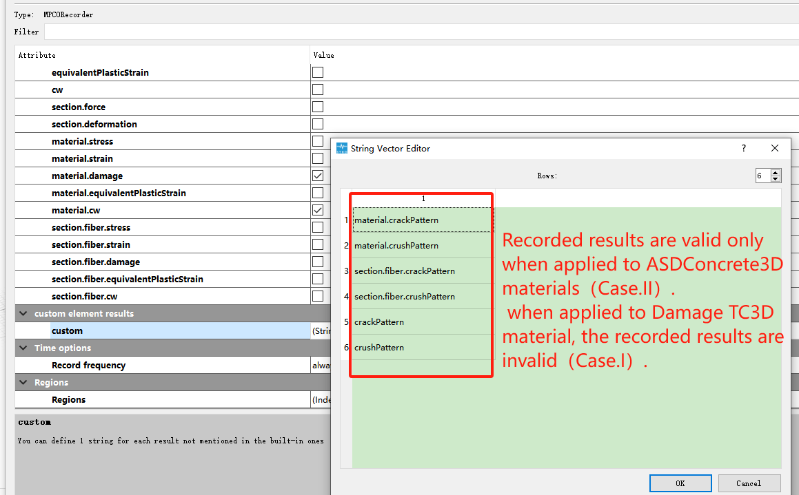

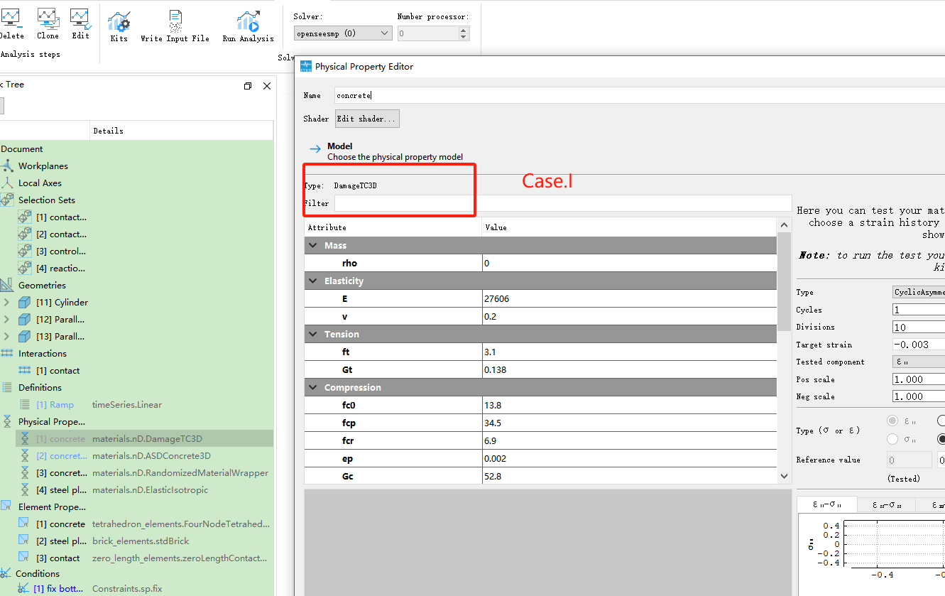

I am encountering a problem while trying to record the crackPattern in my model results. I've noticed that the recording is only effective when using the ASDConcrete3D material. However, when I switch to the Damage TC3D material, the recording becomes ineffective.
Specifically:
With ASDConcrete3D material: crackPattern is successfully recorded
With Damage TC3D material: crackPattern is not recorded
Could you please advise on why this discrepancy occurs and how I can resolve it? Is there a way to record the crackPattern for the Damage TC3D material, or is this feature only available for certain material models?
Thank you for your assistance.
Best regards,
Monace.Pasoke
To adapt the script for a different unit system just change the values you have in the User Input session of the script:
# User Input
# The size of the 3D sample matrix (NxNxN). Don't make it too large!
N = 150
# How many different materials you want to obtain
NThreshold = 20
# the mean value of the compressive peak strength (fcp)
mean = 34.5
# the standard deviation for fcp
sdev = 3.0
# a correlation factor... you can keep it as it is
alpha = -3.5
# the tensile strength
ft = 3.1
# the Young's modulus
E = 27606.0
It's only for ASDConcrete3DI am encountering a problem while trying to record the crackPattern in my model results. I've noticed that the recording is only effective when using the ASDConcrete3D material. However, when I switch to the Damage TC3D material, the recording becomes ineffective.
