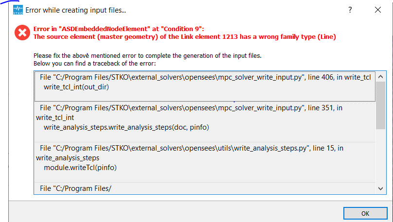

I'm trying to model an infill wall. But I encountered a problem that I could not overcome.
I have completed modeling the frame system but I am having an error : the source element of the link element has a wrong family type
Ekran Alıntısı.PNG (29.06 KiB) Viewed 4580 times

Post by STKO Team » Mon Mar 04, 2024 9:57 am
The error is saying that you used, as a master, some edges of your frame geometry.
edit the master selection and make sure to select only faces

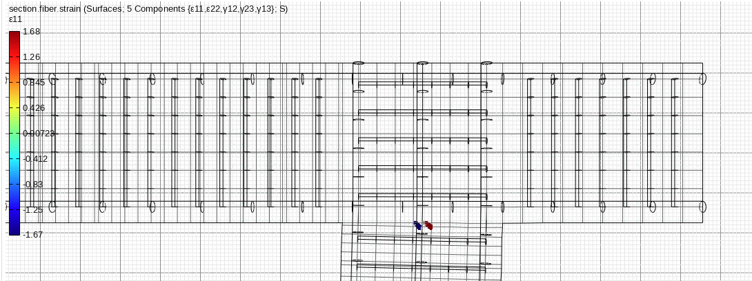

Post by polatd » Sat Mar 16, 2024 12:48 pm
hi,
First of all, thank you for your help.
I change a little bit the model that you send before.
It is seen that the strain values are very high. Am I having any problems with the analysis?
What is your opinion on this sir,
Thank yu..

Post by kesavapraba » Mon Mar 18, 2024 1:58 pm
It is not clear to me which value you used for the strain comparison. You can explain it more clearly. In the 'section.fiber.strain', epsilon_11 should be used for the rebars, but you have shown epsilon_22 component! Please check it.

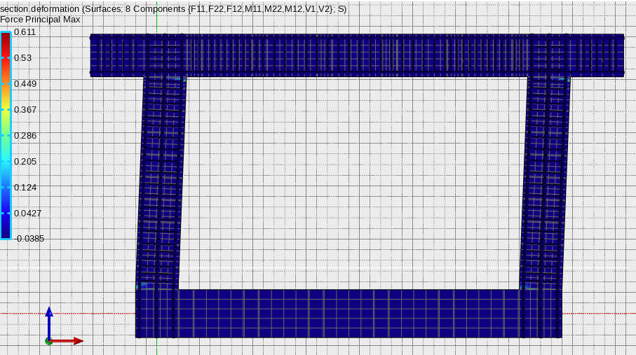

Post by polatd » Thu Mar 21, 2024 1:35 pm
It seems that the e11 the strain of the concrete is quite high.
I dont understand also why initial stiffness values are high.
I tried to adjust the initial stiffness values by changing the material and energy parameters, but I was not successful.
I also tried to model it in 2D, but I'm getting a convergence error here too. I would appreciate it if you could help me understand where I made a mistake in this model.

Post by kesavapraba » Tue Mar 26, 2024 1:28 pm
Hi, You have used UmfPack system for a parallel analysis, it is better to use a Mumps. I changed everything into 3D with shell elements. The model works fine, however you need to check the application of reference load for the displacement controlled analysis. Please refer to the attached file with revised model.
