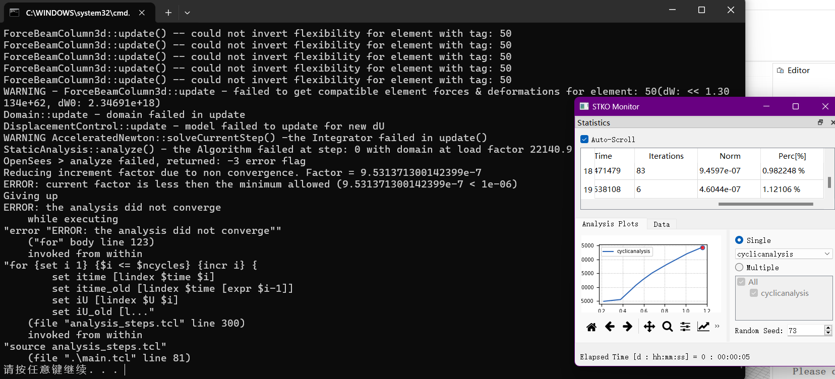

Please help me. This is a two-storey masonry structure built using the equivalent frame modelling approach. When performing gravity analysis and proposed static analysis to obtain the hysteresis curve of the structure, the gravity analysis works fine, but the results of the proposed static analysis always show no convergence. I'd like to know exactly what is causing the non-convergence. There is an associated model scd file below.

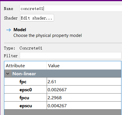

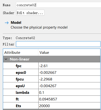

This issue arises due to non-invertibility of system matrix. Near zero (perfect plastic) material can be one of the reasons. You can try using Concrete02 (assigning a low tensile strength, for instance 0.1 MPa) instead of Concrete01 (which has perfect zero for tensile strength). Zero stiffness in the tension zone of concrete01 might cause issue for forcebeamcolum while doing the matrix inversion. Similarly, check other material definition as well.

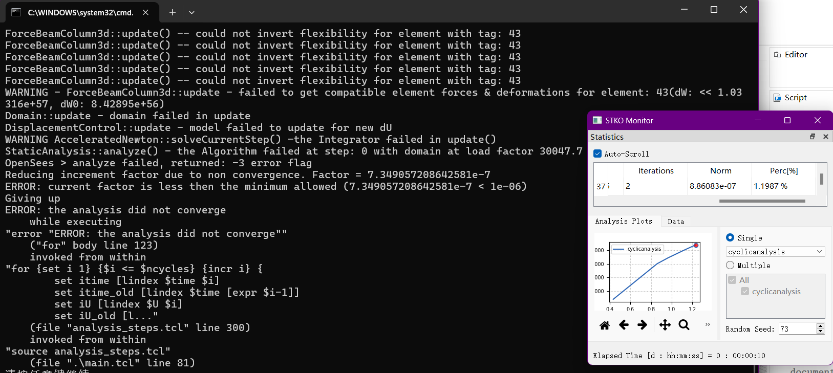

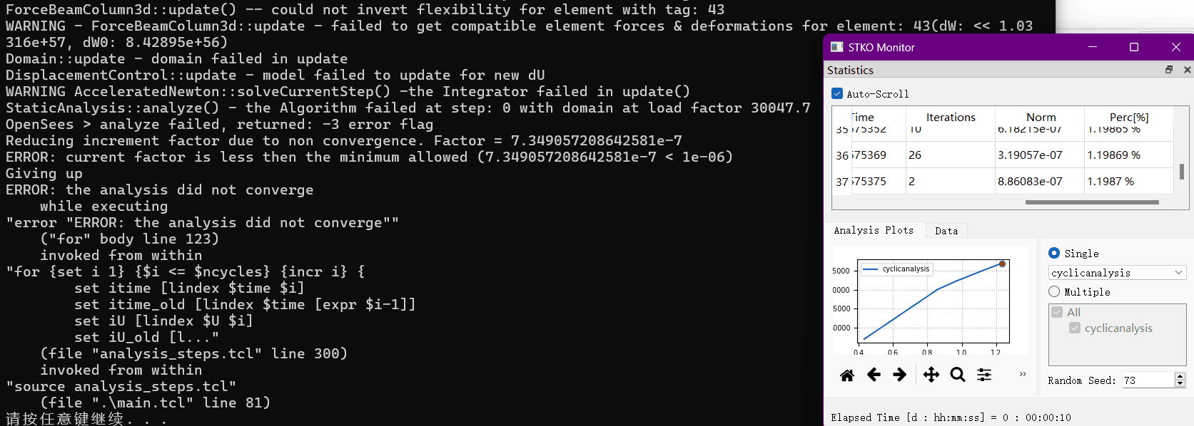

Firstly, thank you for your help. However, after I changed the material in it to "concrete02", the result of the proposed static analyses is almost unchanged and still does not converge. Below are the screenshots of the parameters of concrete02 and the results of the analysis.
