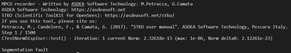

I was trying to record results for the PML elements implemented in OpenSees (https://github.com/OpenSees/OpenSees/pull/503). The mpco recorder seems to work for the 3D PML elements (8-node element) well as shown in the attached image "PML3D.png".
However, it does not work for the 2D PML elements (4-node element), as shown in the attached images "PML_2D (include PML elements).png" (obtained with the newest version compiled by Prof Tarque on Oct 14, 2021, https://drive.google.com/file/d/1ETGQ3Y ... 5Mk7C/view, as seen the analysis stopped at the first step) and "PML_2D (include PML elements, Linux version).png" (compiled on linux, which showed a Segmentation fault was encountered). On the other hand, if I only record regions composed of "normal" elements (2D plane strain elements) the analysis could proceed but of course, no results for the PML elements were recorded (see "PML_2D (exclude PML elements).png").

Probably it is an incompatibility on how the PML2D creates results. If you could send me a Tcl file to test it, I will debug it to speed up the identification of the bug.

Hi, sorry for the delayed response, I was much bogged down by other appointments. Attached please find an minimum example of 2D PML elements that leads to Segmentation fault during runtime. The analysis can proceed by commenting out the "recorder mpco ..." line, indicating the Segmentation error comes from the MPCO recorder. Hope this can get fixed soon. Thanks!
PS: This error happens when using the latest OpenSees source code (as of Nov 21, 2023).

I run your example and it seems the segmentation fault happens also without the mpco recorder if I use the latest OpenSees.
With a previous version, it happens only if I have the mpco recorder.
I think the source of the segmentation fault is still in the PML element. Unfortunately now we don't have time to look into it.
