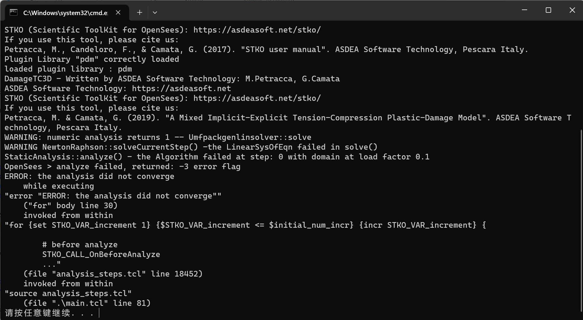

Dear STKO, can you give me some advice to deal with the problem as following pictures. Thanks
converge problem.png (132.85 KiB) Viewed 5482 times
Re: how deal with following problem
Post by STKO Team » Mon Oct 09, 2023 9:43 am
It's saying that the model is singular. Double check your boundary conditions

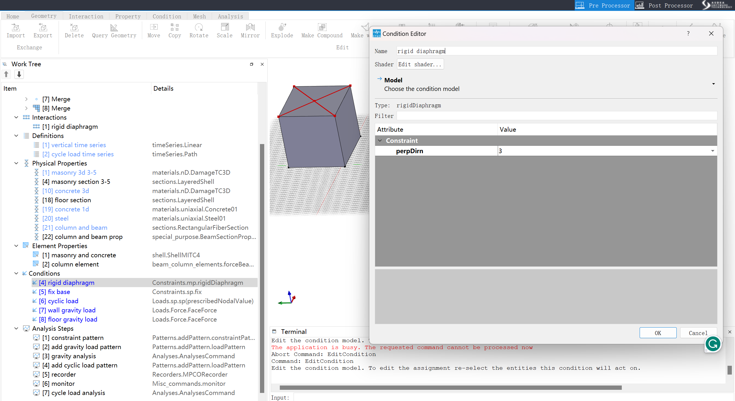

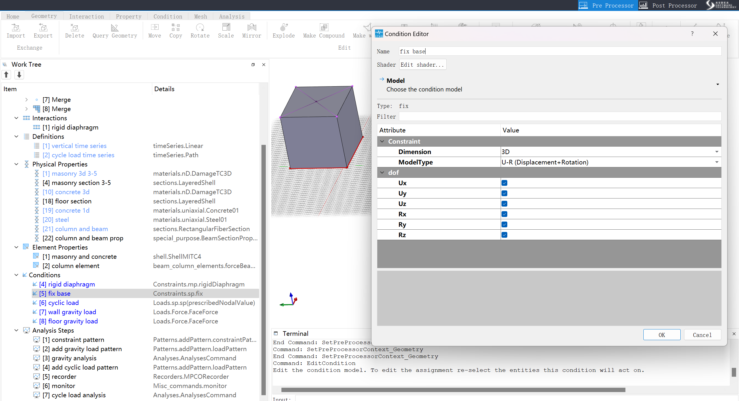

Sorry sir, but I can't understand why the model is singular. The boundary condition is as following pictures. Did I make some mistakes?
Post by STKO Team » Tue Oct 10, 2023 8:10 am
The master node of the rigid diaphragms has 6 DOFs, but only 3 are constrained to the diaphragm (Ux, Uy, Rz).
So you have to fix the other 3
