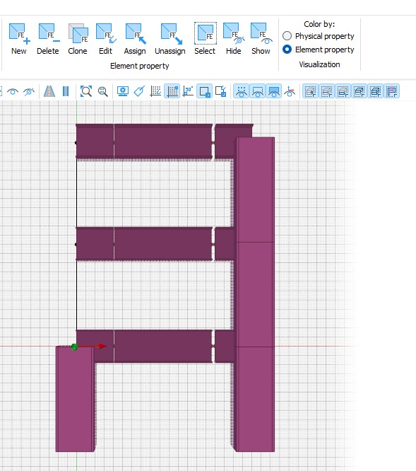

You didn't apply physical and element properties to a part of your model.

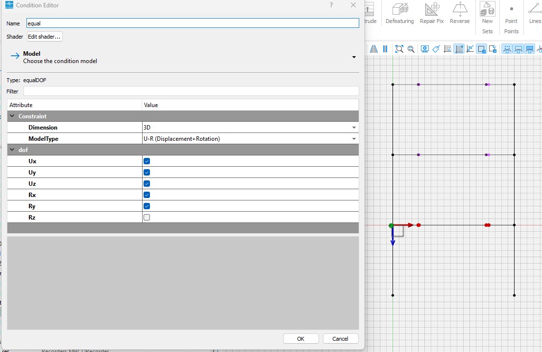

Then you applied EDOF only to two interactions, this is the reason for non-convergence.
