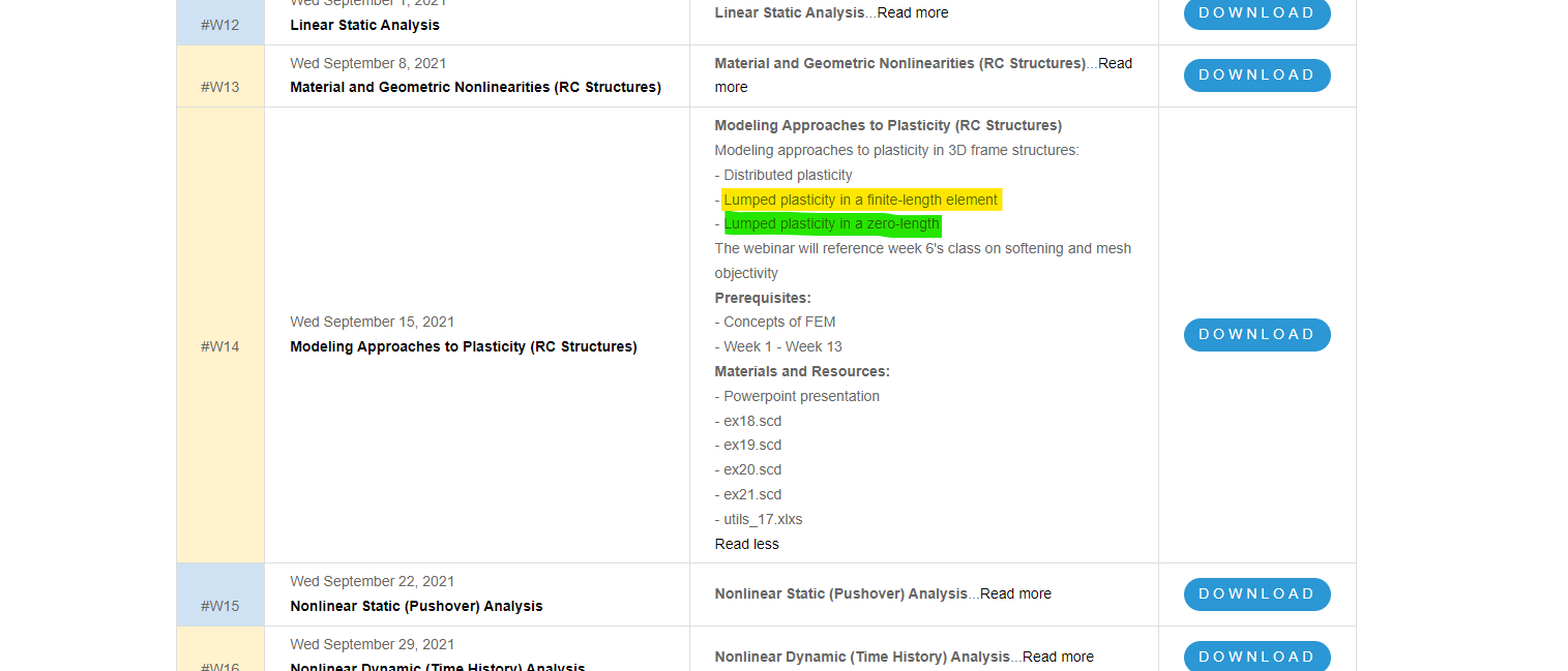

We have 2 types of lumped plasticity:
web lumped.png (68.98 KiB) Viewed 24356 times
Lumped in a finite length using moment-curvature (curvature will be integrated by the FEM code in the finite length of the plastic hinge)
Lumped in a zero Length using moment-rotation (you have to input the rotation as a curvature integrated over the plastic hinge length, because now you don't have this physical length in your model)
