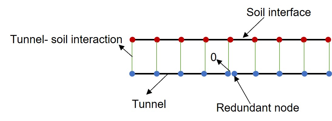

I want to do a seismic analysis for a segmented tunnel using STKO in a plane strain condition. The segmented tunnel is composed of six segments and six joints. The former part is simulated using elastic beam element, and the later part is simulated by the zerolength-rotational spring element. The soil domain is simulated with the quard element. Now, I want to define a slip contact between the soil domain and tunnel interface via the ZeroLengthContactASDimplex Element. I think a nodo to node link is proper to defined the tunnel-soil interaction. However, I found the tunnel contains six more nodes than soil interface, and the six nodes cannot connect with the soil interface, as shown below:
Tunnel-soil interface.jpg (41.93 KiB) Viewed 25225 times
Now, I defined the interface via manually modify the exported tcl, it is inefficient. Can you give me some suggestions to define the tunnel-soil interation in STKO? Should I redefine the geometry or apply other methods?

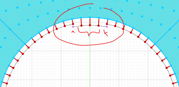

The basic rule in the node-node interaction is that:
Each slave node is connected to the nearest master node
This means that each slave (secondary) node will be connected to a master (primary), but not all masters will be necessarily connected to a slave!

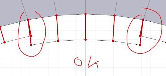

Using this rule, you can simply make the tunnel the slave. In this way, all of its nodes will be connected.
Here I simply moved one segment to visually show this behavior.
With the tunnel as master, you have this:

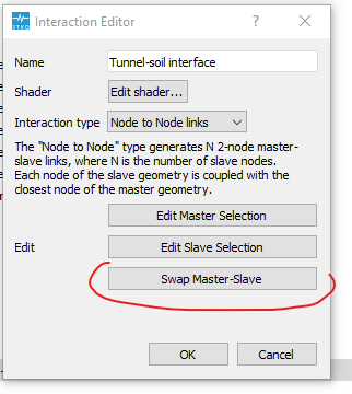

Now you can swap master and slaves:
And you will have this:
