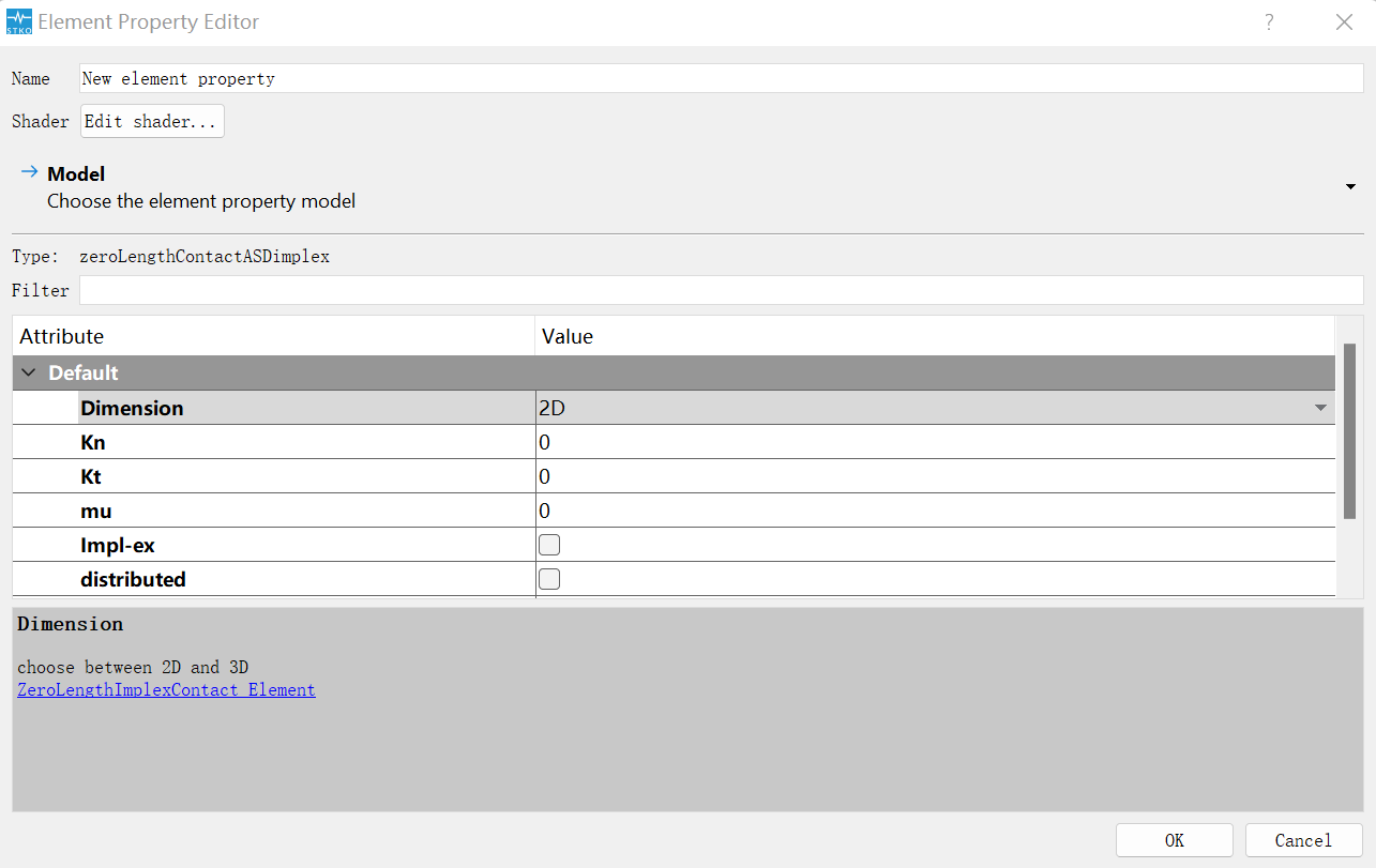

Dear STKO
After I open the STKO software, I select ZeroLengthSimplexContact Element and open the window for inputting parameters (as shown in the figure below). After clicking the blue link, I find that the introduction to me is ZeroLengthContact Element, not ZeroLengthSimplexContact Element. Is there any document that describes ZeroLengthSimplexContact Element?
- 2023-02-19 194226.png (36.83 KiB) Viewed 4604 times

Dear user [email protected],
you can read the information about ZeroLengthContact Element it will help you to understand ZeroLengthImplexContact Element that you want to use. If it is not enough, try to watch this webinar https://youtu.be/tXA5guozrFU where Dr. Massimo Petracca explained more in detail how this element works.
