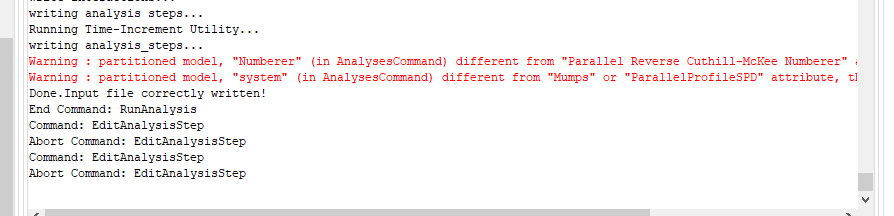

Re: Soil Structure Interface Modeling
Post by STKO Team » Fri Dec 02, 2022 11:40 am
Look at these warnings when you run the analysis:
In the Gravity analysis you did not use the proper settings for parallel analysis (numberer = RCM and system = UmfPack). Doing so, each partition will be detached from each other. It's mandatory to use Parallel RCM and MUMPS
kolozvari
Posts: 227
Post by kolozvari » Fri Dec 02, 2022 3:48 pm
Ah, my bad. I am sorry, should have known better by now. I used the same model for modal analysis and forgot to change this.
Thank you!
