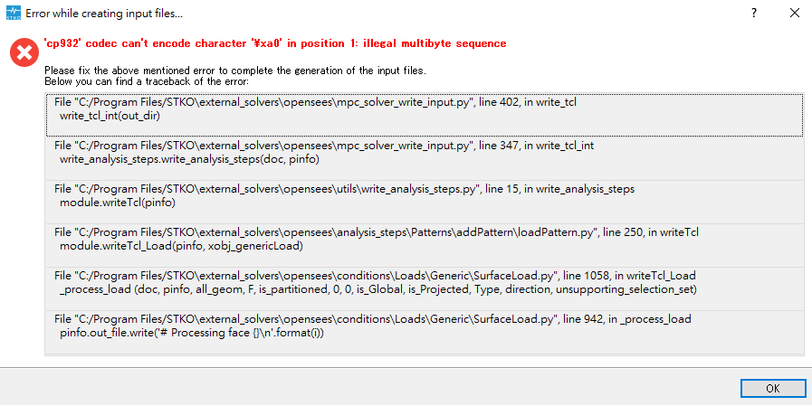

An error pops out when I run analysis with the ex4 in W3:
By removing the analysis steps, I believe the problem is in the 'load',
but I'm not sure what is the reason and how should I edit it.

The error is saying that you have a special character in your output directory.
Please don't use special characters in the files directories.

After changed encoding from Shift-JIS to utf-8 it works to me.
The analysis can run now.
