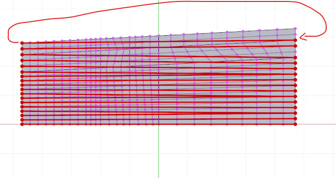

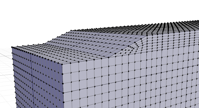

I'm having some problems with meshing.
Can I use energy absorption boundaries when my model boundaries are skewed? When using a damped boundary, do you still propagate at 0.5?
Geometry:
1. When the model established by solidworks software is imported, the external surface and adjacent surface of circular pile foundation are seriously deformed, and the two surfaces are embedded into each other, which makes it impossible to achieve a good interface between different models. May I ask how to deal with it? When using STKO modeling, there is no similar phenomenon, but the complex model solidwork is more friendly. Could you add a dimension standard function in the geometric modeling? When changing the size, the model automatically changes (like solidworks), especially the Angle labeling, while at this stage, only the reconstruction can be deleted, and for tilted models, it is very troublesome.
2, in addition, I encountered a very troublesome problem, modeling, using a straight line to capture, can only capture the midpoint and end points, for complex model non-midpoint, the operation is very troublesome, it is difficult to capture the line, often more than the line, may I ask in the next version, can you add a new function? When near the model edge line, the node automatically adsorbs to the nearest line, similar to solidworks CATIA software provides similar function (automatic adsorption).
Mesh:
3. A new problem is encountered when cutting models. The model does not provide cutting tools. Similar functions such as subtract and intersect require model establishment for segmentation, which is extremely inconvenient for complex models. In the future version, it will provide a function for model cutting. Combining coordinate system, it can use lines, planes and points to segment the model, which is very convenient for complex models of opposite characteristics, similar functions such as solid edit in hypermesh
4. A triangular slope cannot be divided into a hexahedral grid (like a cube), can you provide an example?
5, the circular pile foundation can not be divided into structural grid, must be divided, and if it is inclined pile (inclined pile foundation, it is difficult to be divided in modeling), can you provide a case about inclined pile?
6. In the Mesh part, compared with hypermesh, the convergence of Mesh control algorithm is not too good (the main problem is the generation of structured mesh), and the topology mapping between layers is not too good, and mesh dislocation often occurs. Do you have plans to further optimize the mesh algorithm in the future? Or add a model-to-model interface? (For example, the button interface of hypermesh ensures that adjacent surfaces of different models have common nodes.
7. Can a new function be added in the post-processing of the model? In addition to the box selected node, input coordinates, can get a neighboring point information (like FLac3D input coordinates, can detect the nearest point around the coordinate). The information of the internal nodes of the model is extracted, and the nodes inside the model need to be hidden constantly, and often errors are made, and the box is often selected to the nodes that are not needed
8. Regarding the interfaction function, can you provide an example of how generlink works? And if you use workplane, model segmentation
9. Thank stko team for providing such a good tool.!

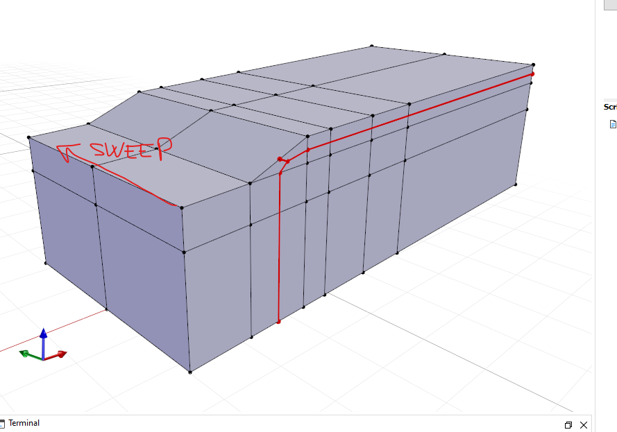

Thanks for all these suggestions, we are continuously integrating new commands into STKO, so we will take them into account.Geometry:
You can draw auxiliary nodes/edges/faces and use them in the Merge command. It will create partitions of the source geometry.3. A new problem is encountered when cutting models. The model does not provide cutting tools. Similar functions such as subtract and intersect require model establishment for segmentation, which is extremely inconvenient for complex models. In the future version, it will provide a function for model cutting. Combining coordinate system, it can use lines, planes and points to segment the model, which is very convenient for complex models of opposite characteristics, similar functions such as solid edit in hypermesh
The constraint of having the same mesh size on two parts of different geometries is already in our todo list, thanks for the suggestion6. In the Mesh part, compared with hypermesh, the convergence of Mesh control algorithm is not too good (the main problem is the generation of structured mesh), and the topology mapping between layers is not too good, and mesh dislocation often occurs. Do you have plans to further optimize the mesh algorithm in the future? Or add a model-to-model interface? (For example, the button interface of hypermesh ensures that adjacent surfaces of different models have common nodes.
Whenever you don't have a built-in function in STKO, you can try the more versatile Python API in STKO. If you don't know how to use it, please have a look at our webinar on the Python API.7. Can a new function be added in the post-processing of the model? In addition to the box selected node, input coordinates, can get a neighboring point information (like FLac3D input coordinates, can detect the nearest point around the coordinate). The information of the internal nodes of the model is extracted, and the nodes inside the model need to be hidden constantly, and often errors are made, and the box is often selected to the nodes that are not needed
Here is a script you can use to do what you want:

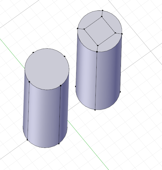

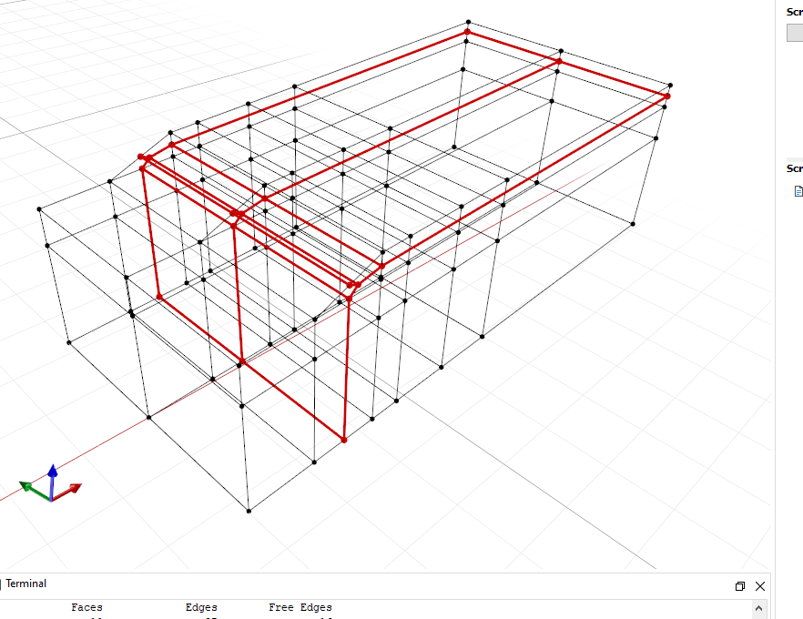

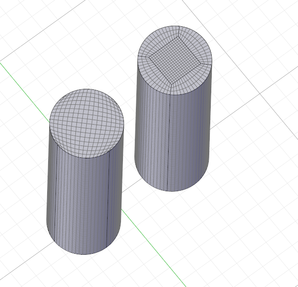

Regarding all the issues you had with creating structured meshes out of triangular or circular shapes, here you can find possible solutions:
For the triangle, you can create lines, like these, and then do a sweep. It will create faces that you can use to partition your model in the merge command:
For the circular shapes, you have 2 options. In both cases you need to make the circular face have 4 corner nodes, or divide it so that each sub-face has 4 corner nodes:

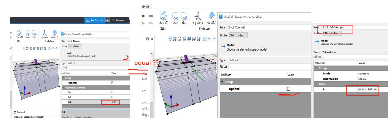

Dear Team STKO
Thank you very much for the solution. I have found a solution to convert the common STEP file with the function of SW software, and the effect seems to be very good at present. I am looking forward to STKO better future and looking forward to STKO developing a set of tools for model cutting in the future.
In addition, I would like to ask a question about the volume force of the soil. When considering the acceleration(Z = -9.81) of gravity, is it not necessary to load the volume Force of the soil in a linear way(Add linear series in Definitions)?
when I refer to the OpenSees and OpenSeesPL cases, there is no linear loading of the soil volume force.

Re: mesh-geom(Inclined site inclined pile foundation)
If you add the body force to the element property, it will be already considered, so there is no need to add the volume force.When considering the acceleration(Z = -9.81) of gravity, is it not necessary to load the volume Force of the soil in a linear way(Add linear series in Definitions)?
Note that the body force in an element is applied instantaneously. That's why we implemented the Volume force automation. It converts the user-defined volume-force(per unit volume) into a set of equivalent nodal forces that can be added into a loadPattern, therefore they can be applied according to a timeSeries.
We are still working on it.PDMY ASDAsorbingBoundary3D nonlinear absorption boundary, do you have a lecture scheduled recently? It is not very ideal to simulate PDMY by using elastic ASDAsorbingBoundary or Bingboundary

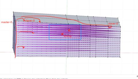

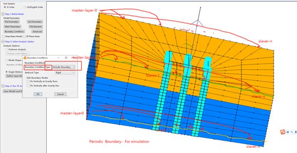

Dear Team STKO,
I'm sorry, I encountered a question, when I need to consider the boundary simulation actual ground conditions, OPenSeesPL website provides a boundary condition to simulate the boundary of the centrifuge test (Periodic boundary), the principle of it is to assume that the boundary of the master node equals the slave node displacement along the grid (developed by shear boundary), However, I cannot achieve similar functions in STKO, could you please help me?
You can do periodic condition in OpenSees. It's the EqualDOF MP constraint.
However there is a theoretical problem in your model.
You cannot make periodic conditions if the two sides have different heights (it does not have a physical meaning).
If the solution vector should be periodic, the mesh also must be periodic:
