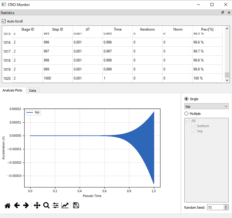

The file which is there on your website for 2D soil model validation under the application of ricker wavelet does not give the same result as shown in the webinar available on YouTube. Can you please confirm why is it happening so?
Results from the monitor defined are attached herewith. Also, in the post-processor, it was found that the wave does not reach the surface.

I think it's due to a recent change in OpenSees. Now it seems that the Linear algorithm with -factorOnce does not work with the TRBDF2 integrator.
Can you confirm that you are using this combination?
You can either switch-off the -factorOnce option, or use another integrator Like Newmark 0.5 0.25

Yeah, now it is working perfectly fine. I have used Newmark 0.5 0.25. Thank You.
