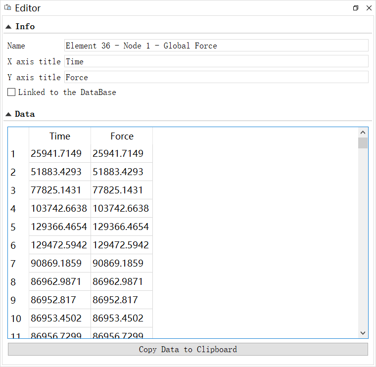

Thank you very much, I successfully extracted the element force. But I found a wonderful thing, the element force and the pseudo time are consistent, why is this?

It's because you are asking the force on the top of the beam, which is the same point of application of the unit lateral force.
This unit force is multiplied by the loadFactor computed by the displacement control analysis. In the displacement-control analysis the pseudo time is actually the loadMultipler (if you are using a Linear timeSeries from 0-to-1).
The total force on the beam top should be
F = Lambda(pseudoTime) * ReferenceLoad
But you are using a Linear time series (X ranges from 0 to 1, and Y ranges from 0 to 1, so it's like X = Y), so:
Lambda(pseudoTime) = pseudoTime
So
F = pseudoTime * ReferenceLoad
But the reference load is 1, so:
F = pseudoTime * 1 = pseudoTime

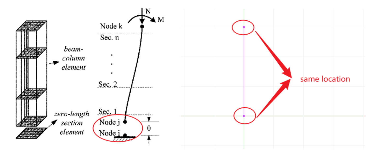

At present, I have built two nodes at the same position in STKO, and they are connected by node to node links. I want to assign the BondSP01 material to the Zero-length section element to simulate bond slip. How to implement it in STKO, can you give a simple example?

1) Create a Fiber Section (physical property) with the BondSP01 as steelDear STKO Team,
2) Create a zeroLengthSection (element property)
3) Assign them to the interaction
