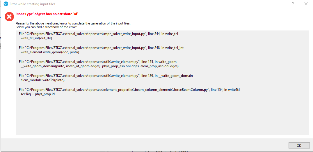

I am trying to do an eigenanalysis of a building, when I run the analysis, I get the 'NoneType' object has no attribute 'id' error. Can anyone suggest me a way that I can solve this issue?
Re: 'NoneType' object has no attribute 'id'
Post by STKO Team » Thu Feb 10, 2022 8:48 am
If you look at the last line of the traceback, it is trying to get the "id" attribute from the "phys_prop" object, which is "NoneType". In python it means it is a null object.
What happens is that at some edge with a forceBeamColumn element property, you don't have any physical property

Hi STKO team, I have similar issue, how do you know which element does not have physical property? I have checked many times.

You have to look at the last line of the traceback of the error.
It will tell you what element is missing a physical property

Dear SKTO team, the last line of the traceback of the error shows lines in the python file, not the element number? I attached my traceback, It looks like something is wrong with the elastic-beam-column members, but I even deleted them and assigned properties again, and still does not work and the traceback is the same. thoughts?
Thanks!
Post by STKO Team » Mon Jun 27, 2022 10:01 am
exactly, it is saying that at least one edge with the elasticBeamColumn element element property does not have any physical property.
namePh = phys_prop.XObject.Xnamespace
NoneType (in this case "phys_prop") does not have the XObject attribute. In fact it is None, which in python means "Nothing", i.e. no physical property assigned.
