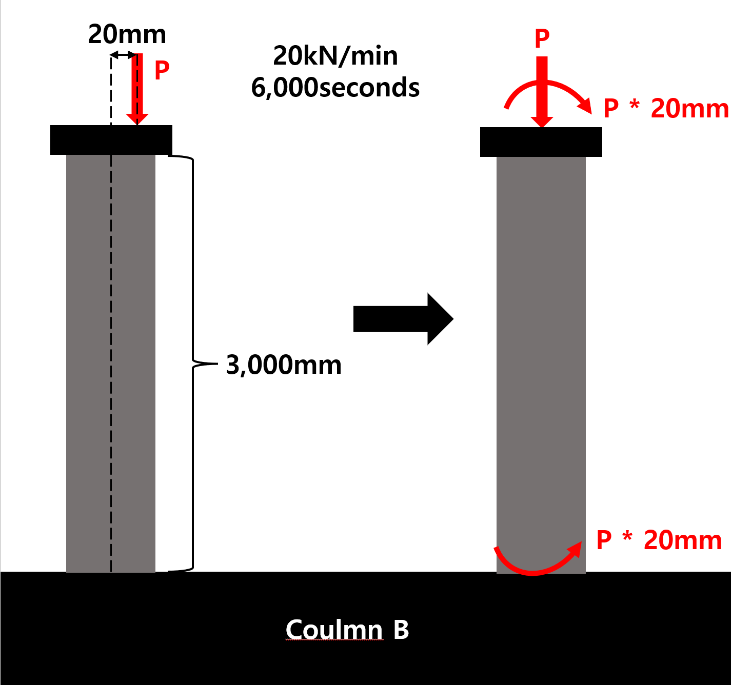

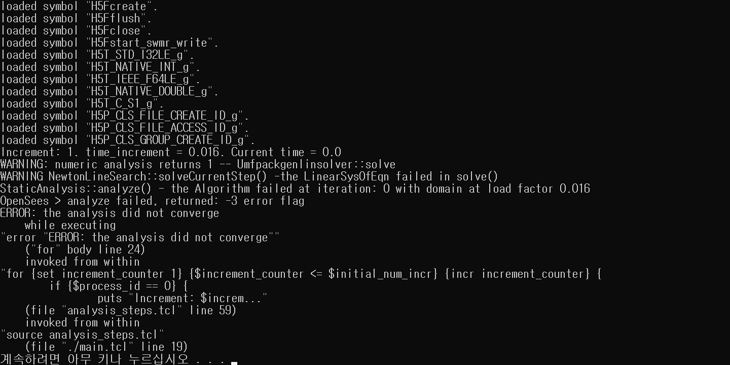

Hello, I'm asking you a question because I have a difficulty in analysis it.
An error occurred during the analysis of applying eccentric load.
Since the eccentric load cannot be applied to stko using the beam element, the analysis was conducted using moment as shown in the picture below.
I set both ends of the column as hinges and analysis it, but the following error occurred.
I think the boundary condition and algorithm are wrong, so how can I solve it?

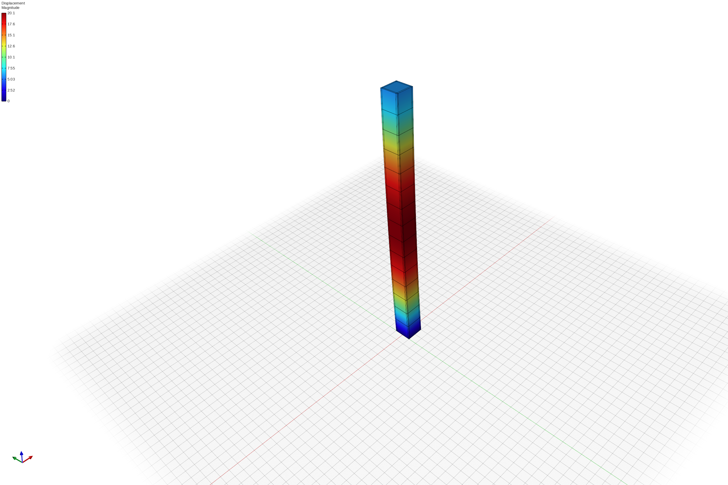

Re: Eccentric load problem

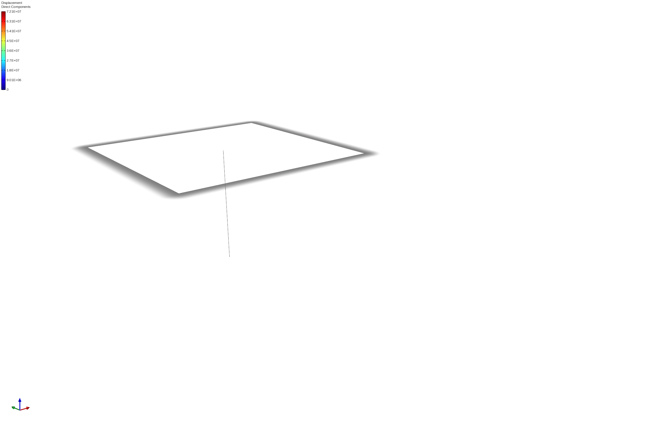

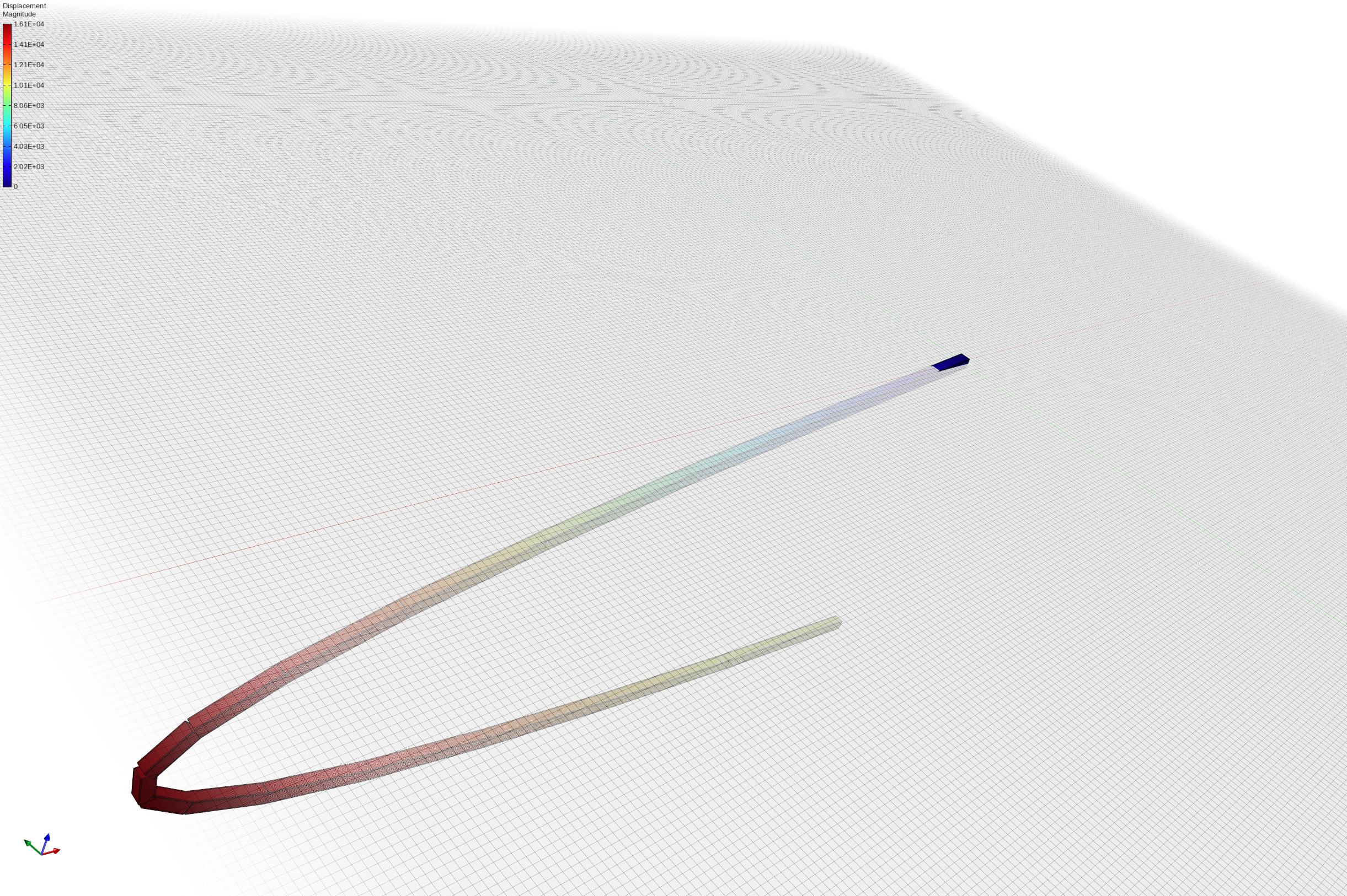

I corrected a few things and got the result values without errors.
However, unlike the desired result value as shown in the picture below, there was too much displacement.
Why are there so many wrong results?
- edit 27 model.zip
- (131.1 KiB) Downloaded 211 times
- edit model.PNG (52.13 KiB) Viewed 4009 times
- result.PNG (33.06 KiB) Viewed 4009 times
- my result.PNG (81.14 KiB) Viewed 4009 times

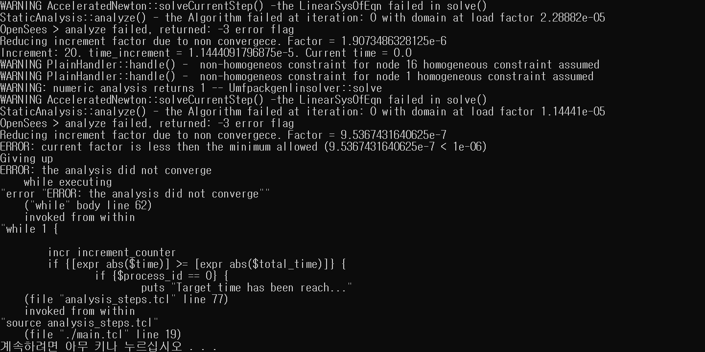

Luis, thank you for answering my question even though you are busy.
I wanted to apply a 20mm eccentric load that increases by 20kN/min for 6,000 seconds.
So I entered a value of 6000, but I think I misunderstood the meaning of 'duration'.
However, i revised and analyzed the input value of the new load, but there is still an error.
This seems to cause an error when I applied a moment by multiplying the load by 20 mm to apply the eccentric effect.
I tried to apply 6666.6N·mm of moment to both ends of the column using 'sp', but 'sp' seems to be a different function.
In Opensees,
load 16 0.0 0.0 -333.33 6666.6 0.0. 0.0
load 1 0.0 0.0 333.33 -6666.6 0.0 0.0
I applied moment in this way, but how does STKO apply it?
In Opensees,

Hello, Luis.
Thanks to this, I entered Moment in STKO and obtained the results close to the experimental results I wanted.
However, I entered the concrete strength low to get a closer value to the experimental results, and the unexpected results came out as shown in the picture below.
In addition, even if the concrete strength is increased by 1 MPa, strange results.
If you enter a value other than 33 MPa of concrete strength, you will get a strange result.
Which part should I correct to solve this problem?
When defining concrete, should we change not only the strength of concrete but also the other values input to concrete 02?
For Model 27, input 33 MPa of concrete strength.
Enter 25 MPa for Model 27_1 and 34 MPa for Model 27_2, and there is no difference.
- test and model 27 result.png (107.55 KiB) Viewed 3965 times
- Model27_2 Result.PNG (3.42 MiB) Viewed 3965 times
- Model27_1 Result.PNG (3.42 MiB) Viewed 3965 times
- Model 27 Result.PNG (1.91 MiB) Viewed 3965 times
- Model27_2.zip
- (126.49 KiB) Downloaded 191 times
- Model27_1.zip
- (126.39 KiB) Downloaded 189 times
- Model27.zip
- (126.46 KiB) Downloaded 189 times

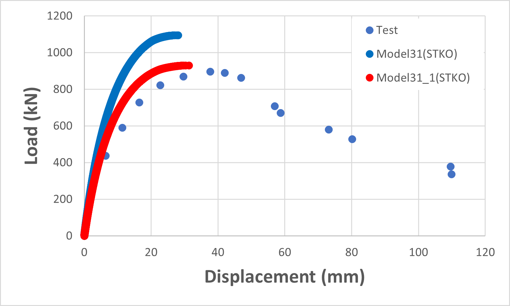

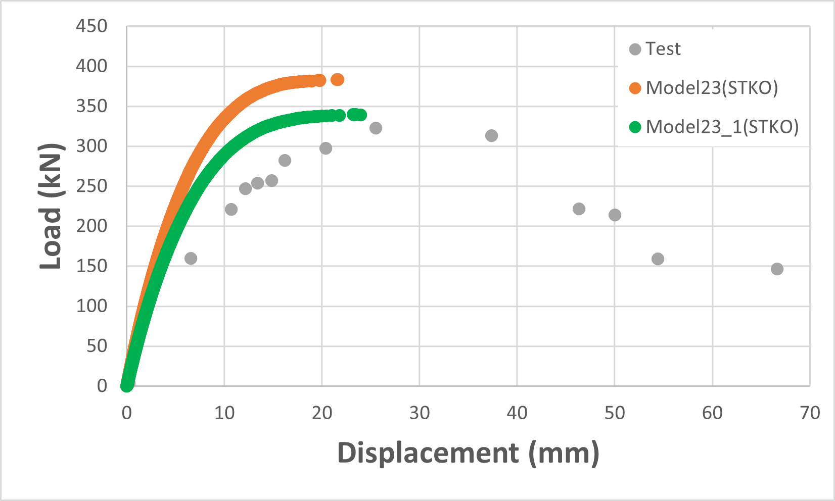

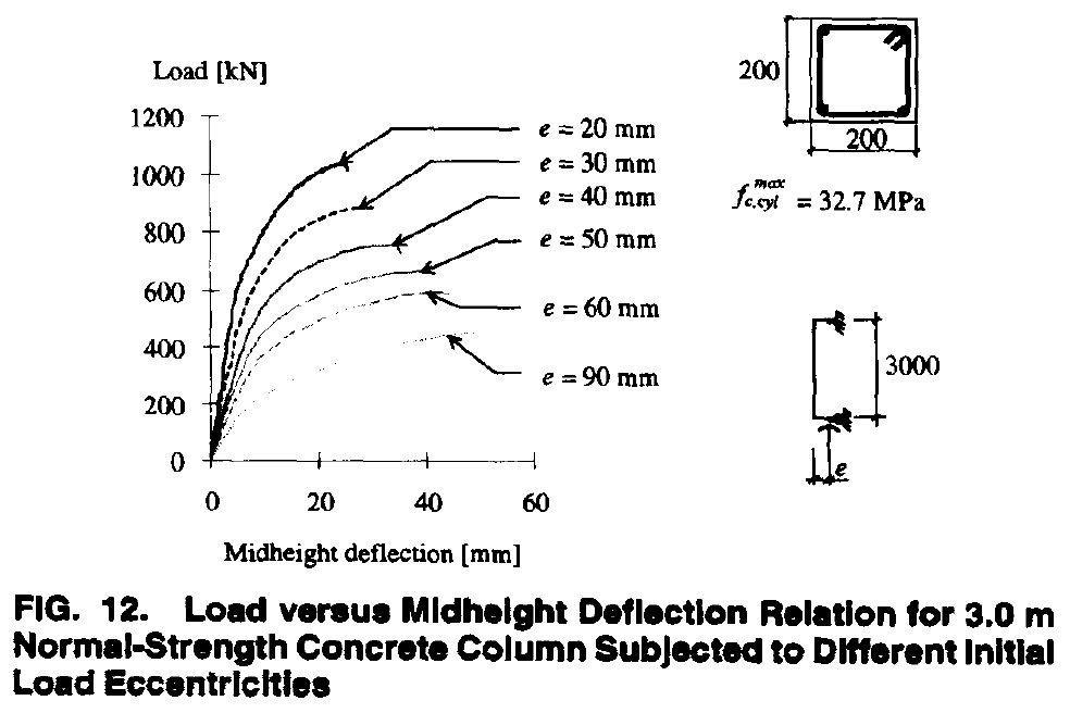

Hello, Francesca.
In the figure below, the cylinder strength of concrete was used for Test and Model, but in some papers, the concrete strength 8MPa was modeled lower for Model_ because it was 8MPa lower than the cylinder strength. However, the professor said that it is right to use the cylinder strength shown in the experimental paper when analyzing.
So, the difference between the experimental results of the model and the test seems to require studying about materials.
- Model31.zip
- (126.38 KiB) Downloaded 202 times
- Model27.zip
- (126.44 KiB) Downloaded 202 times
- Model31 Result.png (76.27 KiB) Viewed 3945 times
- Model27 Result.png (112.29 KiB) Viewed 3945 times
- Model23 Result.png (88.25 KiB) Viewed 3945 times
- Posts: 363
Good job!
I don't remember what you are using, but if you run your analysis in displacement control you should be able to obtain the post-peak response. And yes, material calibration is really important!
Enjoy your modelling
Francesca
Francesca
