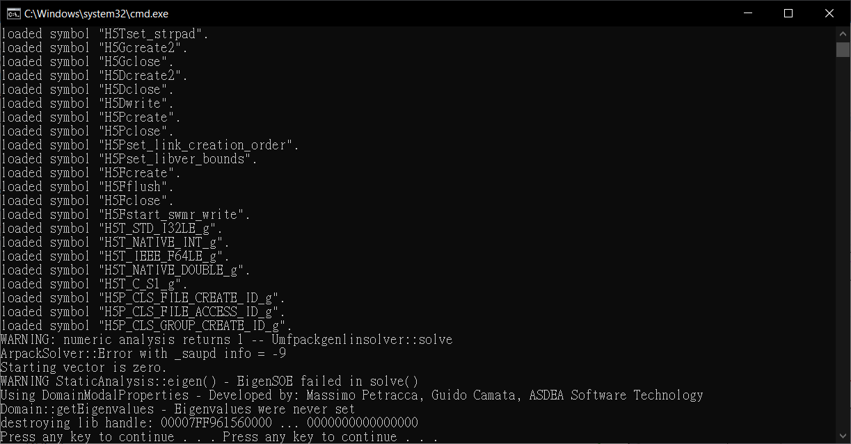

I am studying the friction pendulum bearing modeling and got few questions to ask as follows:
I simply use the base model provided in the website https://asdeasoft.net/?webinar#019 and delete all the geometries and rebuild it. I stuck on the modeling when I add the diaphragm. For the "WithoutDiaphragm.scd" is runnable, but for the "WithDiaphragm.scd" is not runnable, it occurs an error "starting vector is zero".
Model.rar
(247.46 KiB) Downloaded 185 times
How do I fix the modeling? And how to prevent this error later on?
Thank you very much
Best regards,
Natalia Lioe

You assigned 3 masses (Mx My Mz) to 2 nodes, so you have a total of 6 free DOFs with mass (dynamic DOFs).
The default solver in Eigen is the -genBandArpack. This solver is good for large problems (dense or sparse) but can give you at most N-2 eigenvalues, where N is the number of dynamic DOFs.
You requested 3 eigenvalues.
This is fine without a rigid diaphragm, because 3 < N-2 (4).
When you add the rigid diaphragm, the 2 nodes with mass are constrained to the master node, and so you end up with 4 dynamic DOFs (mx and my are constrained, + 2 mz components).
So in this case you need to use the -fullGenLapack solver, which can give you all eigenvalues, but works only for small problems.
Another issue is that you need to FIX the Uz,Rz,Ry DOFs of the master node, otherwise your structure is un-stable
