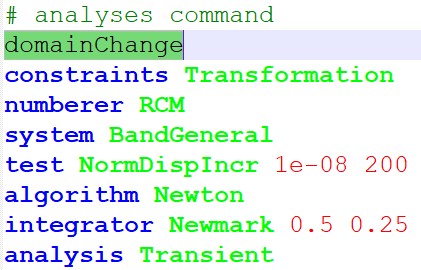

Dear STKO Team:
There is a question I want to ask.
When I checked the analyses command, I found there is "domainChange" in the first row.
What does the command mean? Could I delete it?
Any advice and helps that you provide are highly appreciated.
Best Regards
analyses command.jpg (43.72 KiB) Viewed 1318 times
Re: Question about analyses command
Post by STKO Team » Fri Jul 16, 2021 2:59 pm
If you do just 1 analysis it does not make any difference.
In terms of results it does not make any difference either.
It is only used by the MPCO Recorder to separate each analysis into different model stages
