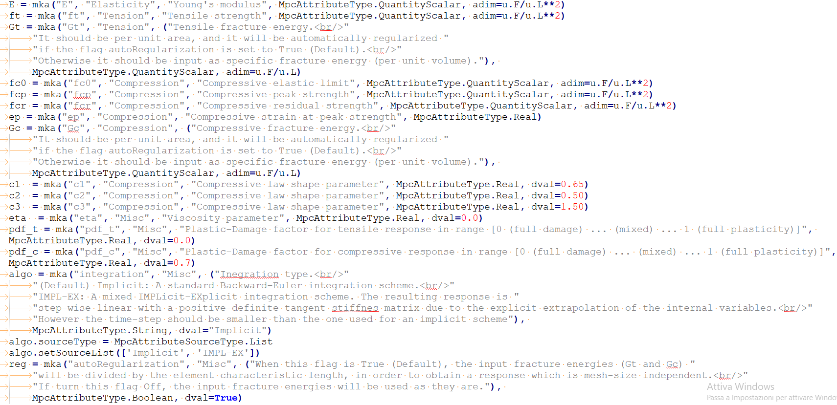

For DamageTC3D you can do the same. As you may have noticed different attributes have different types. To check the type of a specific attribute you can go into this folder on your computer:
C:\Program Files\STKO\external_solvers\opensees
And search for the python file related to the XObject of interest. For example, as you see in the image below, the young modulus is a quantityScalar, while the Compressive law shape parameters are QuantityScalar.
