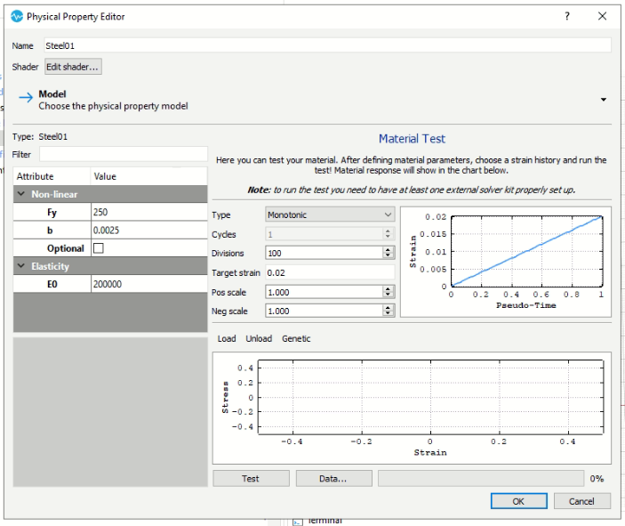

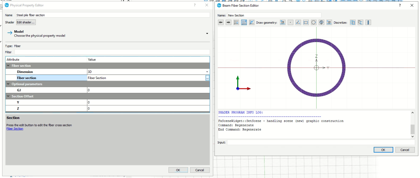

I tried to use fiber section with Steel01 material and i get this problem, what does it mean? And where is the problem?

Re: Error Analysis : Laterally loaded pile with BNWF
In your fiber section, GJ is 0.
So your beam is singular in torsion.
