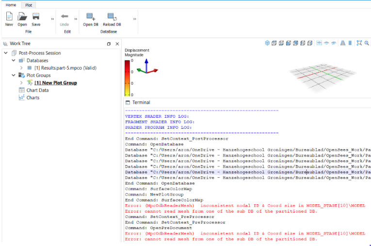

After I run the analysis properly which I didn't receive any error or convergence problem during the analysis, I had the error attached when I used the post-processor. I would like to ask you If you could help me with how to solve this problem.
Thank you in advance.

Dear gercekonur,
could you send us your model in a zip format so we can have a better look? If you can attach the output database too.

Actually, Massimo told me what it is!
Try to erase or move the old database from the previous analyses from the folder you are saving the new one.
What is happening is that the post-processor is reading with ou new databases also others from a past run. For example, if you first tried with 10 partitions, and then with 8, the first 8 will be overwritten, but the last two now, and will give you that error.
Let us know if you manage to move forward from this error.
Francesca
