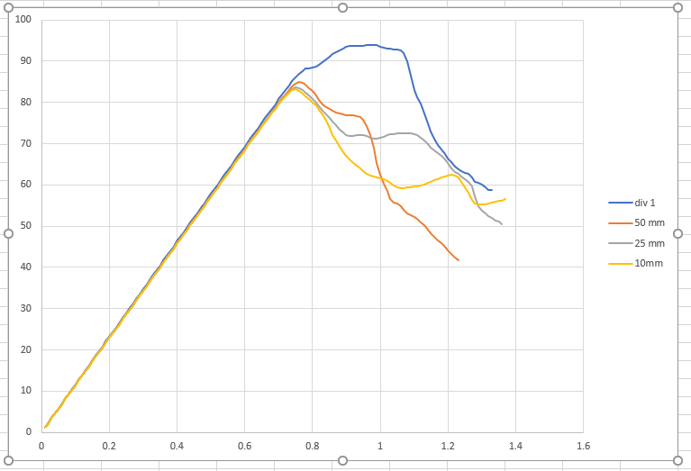

Re: Help in deciding mesh and step size
As you can see here, refining the mesh converges to an (almost) unique solution.
"Almost" because:
The stable part (until the peak) converges to a unique value, while in the post-peak regime, there is a larger scatter, and this makes sense because once the system becomes unstable, the finer is the mesh, the more "freedom" the crack pattern has.
"Almost" because:
