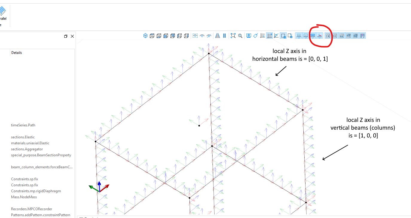

Option 2 is quite easy instead. You just have to follow 2 simple rules.
For beams (element in the X-Y plane) use vecZ = [0, 0, 1].
For columns (vertical elements) use the vecZ = [1, 0, 0].
Let us know if it solves your problem.

I will try to apply option n.2 by modifying the fiber section generator, applying a 90° rotation. This will require applying the geometric transformation with vecz vectors as the default ones in STKO. This should be enough to resolve the problem and plot the sections as I expect.
