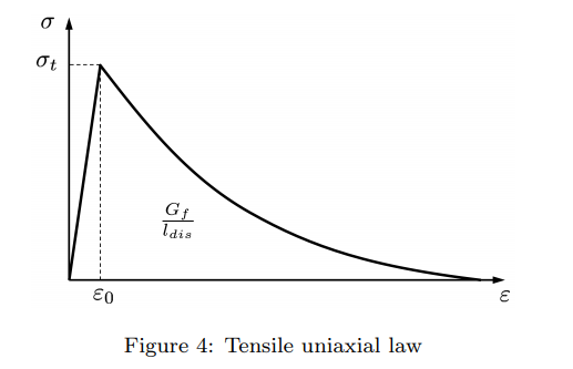

These are good parameters to start with, for a concrete with 30 MPa of compressive strength (values given assuming N/mm^2). As a first approach to this model, change only the Elasticity parameters, and the parameters I highlighted in the picture below. Play with them and use the material tester to see how they influence the response.
Click on each of them to see their description in the text-bot at the bottom of the material editor.
Parameters highlighted in Yellow are for the tensile response
  • ft: tensile strength
  • Gt: tensile fracture energy
Parameters highlighted in Green are for the compressive response
  • fc0: elastic limit
  • fcp: peak compressive strength
  • fcr: residual strength
  • ep: strain at peak compressive strength
  • Gc: compressive fracture energy
Parameters in orange are algorithmic parameters. the autoRegularization deals with the topic of fracture-energy-regularization for an objective response with different mesh-sizes (you can read about this in my paper and the references therein)
The integration instead is not given in that paper. The implicit is the default one, the time-step size can be whatever you want, because the solution will be implicit, so it will iterate for covergence. If you use the IMPL-EX (mixed implicit explicit) your problem will (almost) always converge, however the time step should be quite small.
Try with these first informations and let's see if you need more

ok thanks .. I also saw the videos on youtube related to this material. Now it is clearer to me. But a question, how can I calculate the values ​​of Gt and Gf, in case I don't have them from experimental data?
Re: Difference between RigidLink Beam or Bar
Post by STKO Team » Mon Oct 26, 2020 10:09 am
If you don't have experimental data, you can fomulas given in national codes, for example, for the CEB-FIB Model code:
Immagine 2020-10-26 110434.png (3.75 KiB) Viewed 4105 times
These values are real fracture energies (i.e. Work per unit-area... for example if you're using N-mm as your units, N/mm]). You can input them as they are (N/mm) if you use the -autoRegularization option.
Otherwise, you should input them as specific fracture energy (N/mm^2 dividing them by the characteristic length of the finite element).
I suggest you to always use the -autoRegularizaiton, because in that way, it will be OpenSees itself, that will regularize the fracture energy for you.

Ok thx. I have found the first eq. (Gt) on the CEB - FIP Model code 2010. But the second (Gc) no. Where can I found it?
Although I tried to use the equation for Gt but I don't get the values ​​that are in the picture
Fri Oct 23, 2020 8:32 am
Post by STKO Team » Tue Oct 27, 2020 12:11 pm
The one for compressive fracture energy in that equation is simply derived from the Tensile fracture energy (given in the FIP Model Code) and scaled by the square of the ratio of the compressive to the tensile strength.
