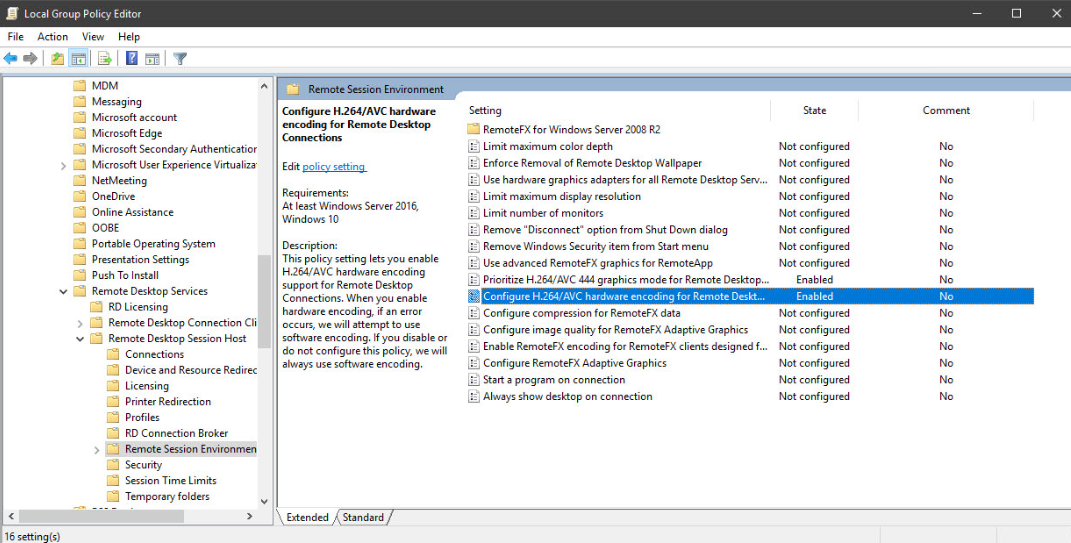

If you are accessing your Host PC with Microsoft Remote Desktop, this is a known issue. There is a way that might work (not sure 100%):
RDP has a way to make it use the h.264/AVC 444 hardware encoding. On Windows 10 (do the same both on the Host and on the Client PC) Start the Group Policy Editor by clicking the Windows button and typing gpedit.msc then under Computer Configuration -> Administrative Templates -> Windows Components -> Remote Desktop Services -> Remote Desktop Session Host -> Remote Session Environment : 1. Prioritize H.264/AVC 444 Graphics mode for Remote Desktop connections. When enabled on the RDP Server, the H.264/AVC 444 mode will be prioritized when the RDP 10 client and server both support AVC/H.264 and support the AVC 444 mode.
If present on your windows 10, there is a second option that needs to be enabled. Configure H.264/AVC hardware encoding for Remote Desktop Connections. Double click on both the Prioritize and Configure and choose Enable and Apply.
