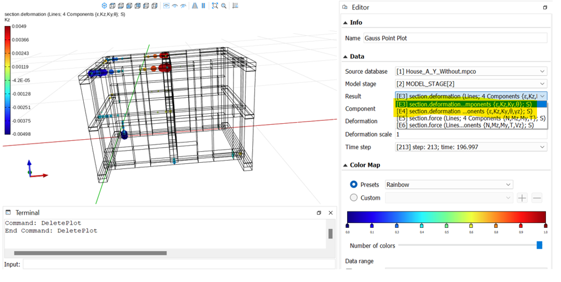

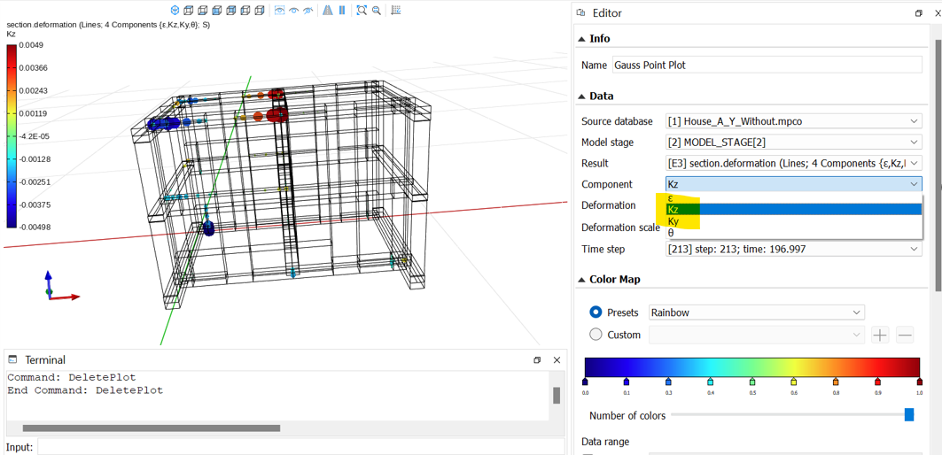

I’m trying to visualize the progressive formation of plastic hinges. My model is a two story masonry building, built using the distributed plasticity approach (Fiber sections). So, as suggested in the previous post, I’m doing the gauss-plot in the post-processor using the curvature as the result. My questions are the following :
1 – Which result should I use ? E3 or E4 ? And why ?
2 – Which component ? ky or kz ? And why ?
3 – The results are the same for the piers and the spandrels ? Or the component chose depends on the element ?
The only difference between E3 and E4 is that E4 has shear deformability along the local Y direction (probably you used a section aggregator), while the E3 does not.
It depends on your model. If you want to visualize results on shear-deformable elements, use E4, otherwise use E3. But you are the only one knowing which element has the shear-deformability.
It depends on your local axes. Go in the pre-processor and visualize the local axes, so that you will see what curvature you need.
This is related to your first question. Piers and spandrels will have the same results if both are shear-deformable (E4) or not (E3). Once again, you are the only one knowing this.

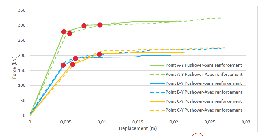

Hello STKO team,

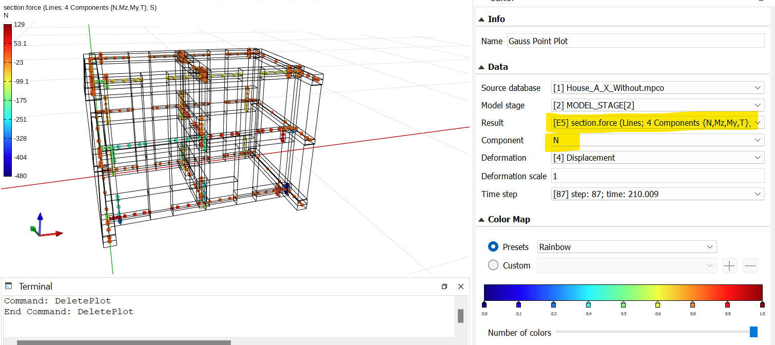

Thank you for your previous response. However, I’m trying in fact to visualize the progressive formation of plastic hinges, in concordance with the force-displacement curve. In that case, will it be more pertinent to see the section.force results (E5 – E6), and what is the difference between the two ? If yes, which component (N or T) ? And why ?
Capture d’écran 2023-02-28 105315.png (176.57 KiB) Viewed 4977 times
Capture d’écran 2023-02-28 102518.png (53.42 KiB) Viewed 4977 times
Is there a way to know if the failure is caused by the flexion/shear mechanism ?
Many thanks in advance !
To visualize deformations or forces it is up to you. E5 and E6 should be also as E3 and E4 with and without aggregator. N is normal force and T is torsion.
Chaymaa wrote:
Tue Feb 28, 2023 3:54 pm
Is there a way to know if the failure is caused by the flexion/shear mechanism?
You need to analyze your results to see if it is a shear or flexural failure.
