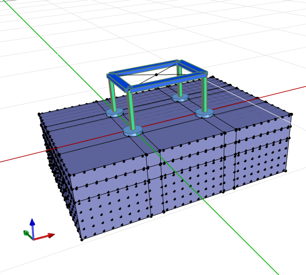

Hello! I'm new to STKO. I have read the manual and watch some of the videotutorials. They are very good and instructive. Thanks for doing and uploading them.
My problem has do with soil foundation structure interaction. I have modelled a simple 3D one-bay frame following one of the tutorials. Then, I added the foundation and soil as solids following another tutorial.
I have fixed the bottom surfaces of the soil in the Z direction. I also fixed the sides soil surfaces in the X and Y direction, respectively. However, an error apperared saying that those nodes were already fixed in the corresponding direction. I deleted this condition and the analysis started but I think they should be fixed, as seen in the SSI tutorial.
I added EqDOF in the soil and foundation solids in each direction. I also added them to consider the interaction between the soil and the foundation. I used the beamsolidcoupling constrain to link the base node of the columns and the top nodes of the foundations. I found this command in the STKO manual. Maybe I did not apply it correctly.
However, the analysis does not run and I can not find the error. Maybe, it is related to the DOFs restrictions or the material properties. I have modelled the struture in N/mm. Could you help me trying to guess what can be wrong?

Hi again! I have redone the model using SI units and I have not deleted the fixities of the soil slides.
Looking forward to hearing from the community.

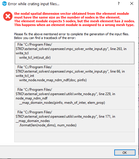

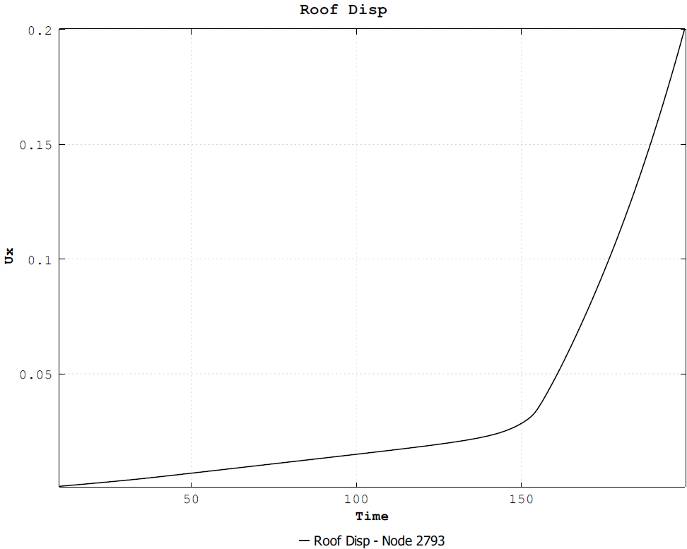

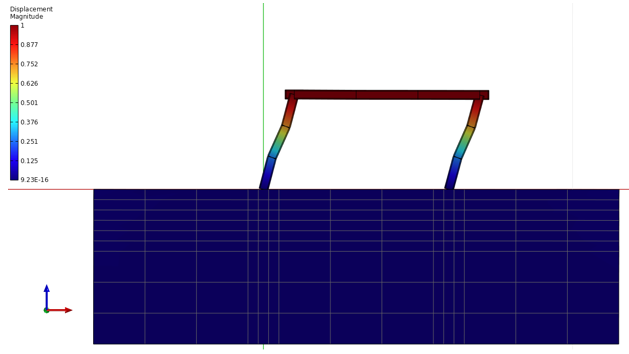

Hi again! I have been busy these past few weeks. I have continued working on this model.
I have performed the pushover analysis and I finally got some results...However, I compared the pushover curves obtained for the model without (columns fixed) and with the soil and they are practically the same. However, it seems that the soil is moving (deformed shape captures), but not enough. I tried to increase the load factor but the results were the same.
Then, I tried to apply a SimpleContact3D element and corresponding ContactMaterial3D in the interaction between the soil and the foundation. And a different error appeared...maybe related to the mesh options? I have read that "The SimpleContact3D element is a three-dimensional node-to-surface contact " and that's why I can't use it for this type of interaction. Should I move to using Zerolength elements and the STKO SSI tutorial????
Regards.

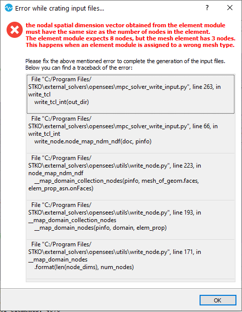

Re: soil structure interaction
Hi again! I have decided to model the foundings as they were a pile as in viewtopic.php?f=29&t=1623... I am just trying different solutions.. But again, a new error appears... It definetly has to do with the meshing but neither can I delete surfaces to redo them nor change the edge sides...
- capture7.PNG (78.22 KiB) Viewed 9166 times
- capture6.PNG (30.5 KiB) Viewed 9167 times
- p9.rar
- (221.43 KiB) Downloaded 386 times
dear User,
model didn't work beacuse geometries were not solid but faces. With SSpbrick is necessary to use solid geometry and structured hexaedric mesh. If faces are merged they still are faces, but you can extrude them in order to obtain solid geometry.
With dispbeamcolumn is necessary to use the special purpose beamSectionProperty as physical property, as shown in the model attached.
BeamContact3D requires radius in input properties, not diameter, and their orientation has to be the same of the beam connected. If is not, it's necessary to apply local axes to interaction.
We hope to be helpfull. Please, let us know if you need any help.
Have a nice day.
Have a nice day.
