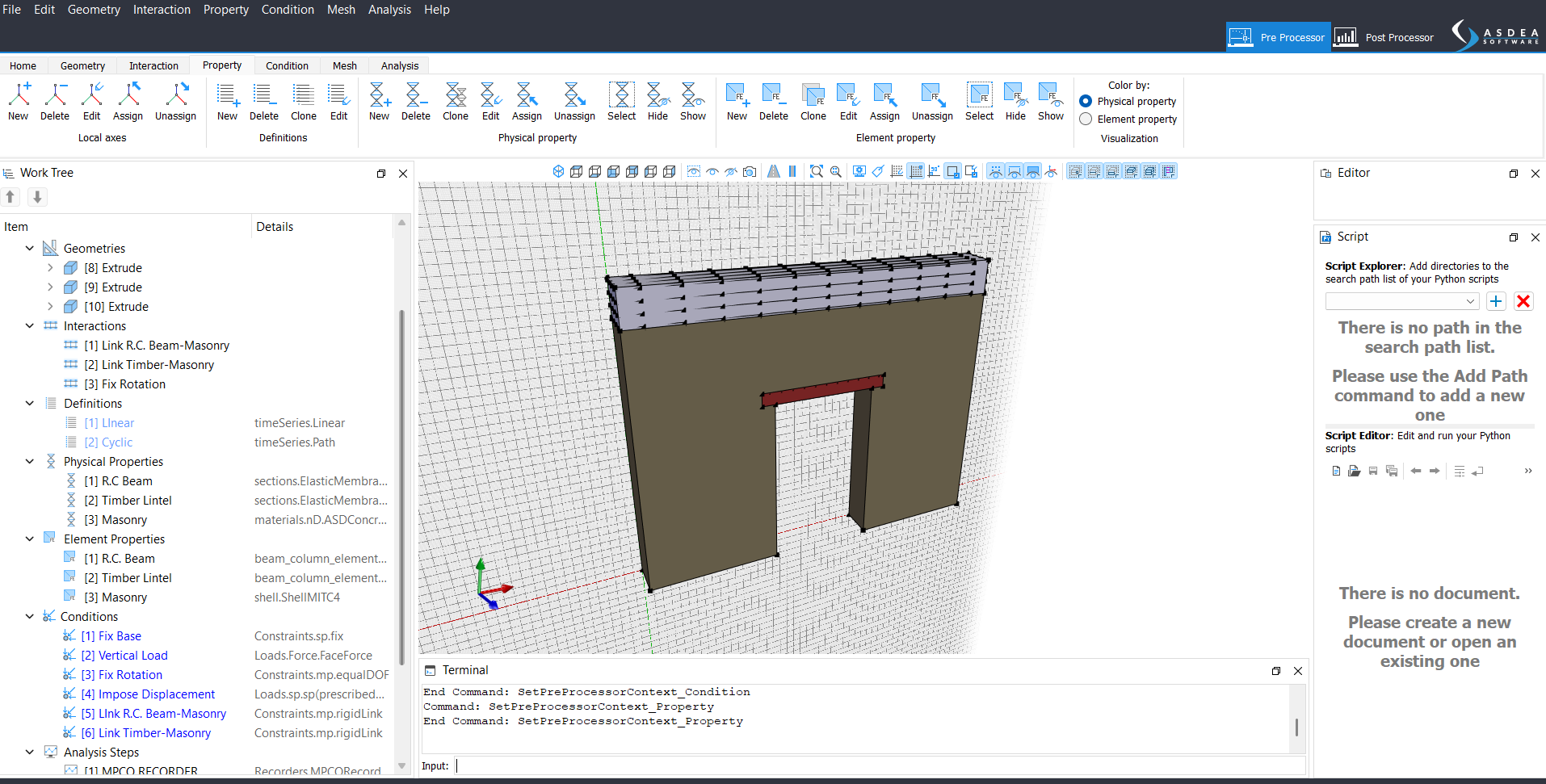

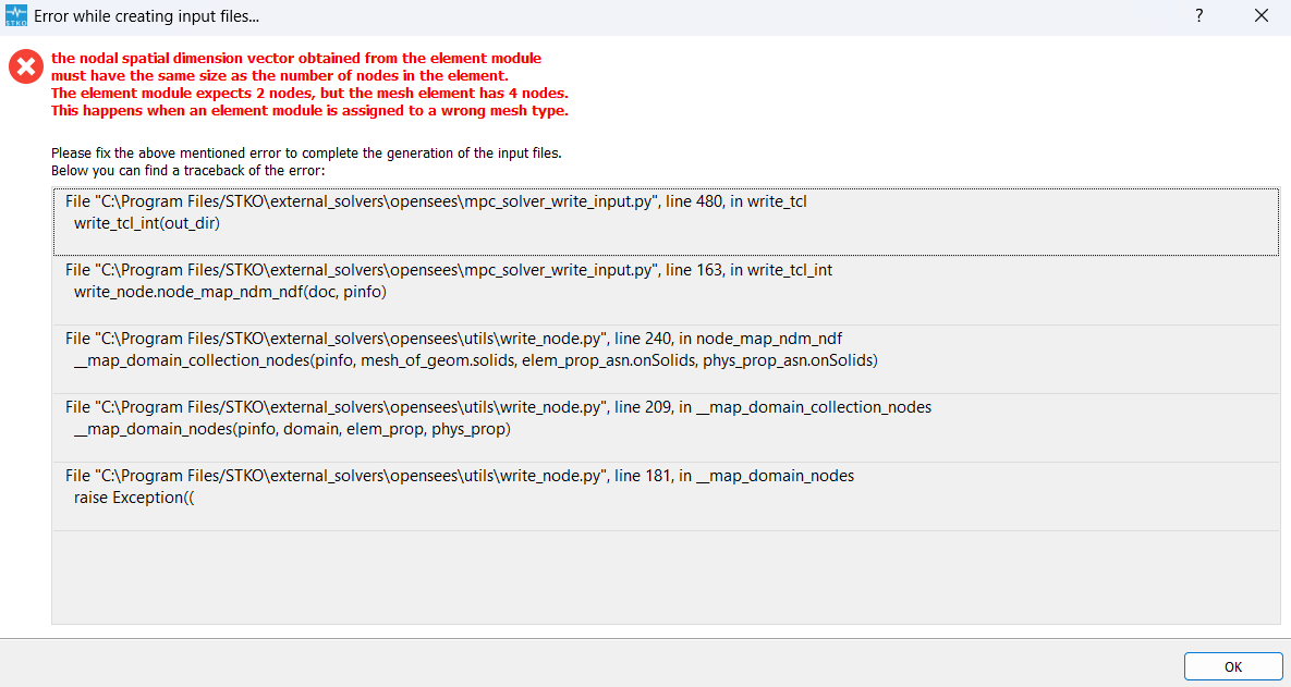

I am modeling a masonry wall with an opening in the middle, and I am facing some errors while trying to analyze it. The error that pops up is shown at the attached image. If you have any advice, I would be grateful.

The error is clear: You assigned an ElementProperty that expects 2 nodes (probably a beam?) to a mesh with 4 nodes
