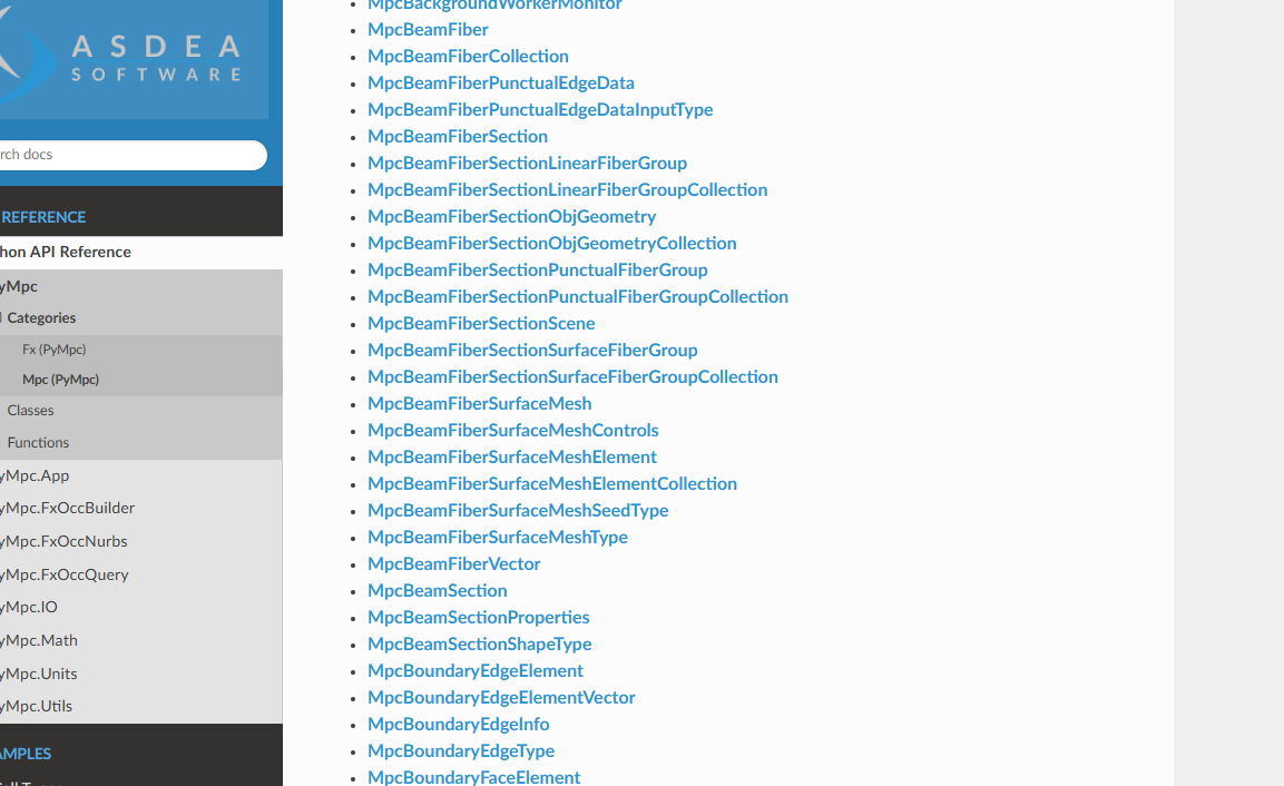

I am currently working on a structural model that contains more than 100 reinforced concrete columns/Beams. Since each of these columns/Beams requires a fiber section definition, creating them manually through the GUI is very time-consuming.
I visited your website and noticed that Python API support for generating fiber sections was mentioned as "coming soon" Could you please confirm whether this functionality is already available, or if there is an alternative workflow to efficiently create multiple fiber sections through scripting?

You can try to have a look at the documentation for the classes (no example yet though)
https://asdeasoft.github.io/STKO-Python ... c/Mpc.html
