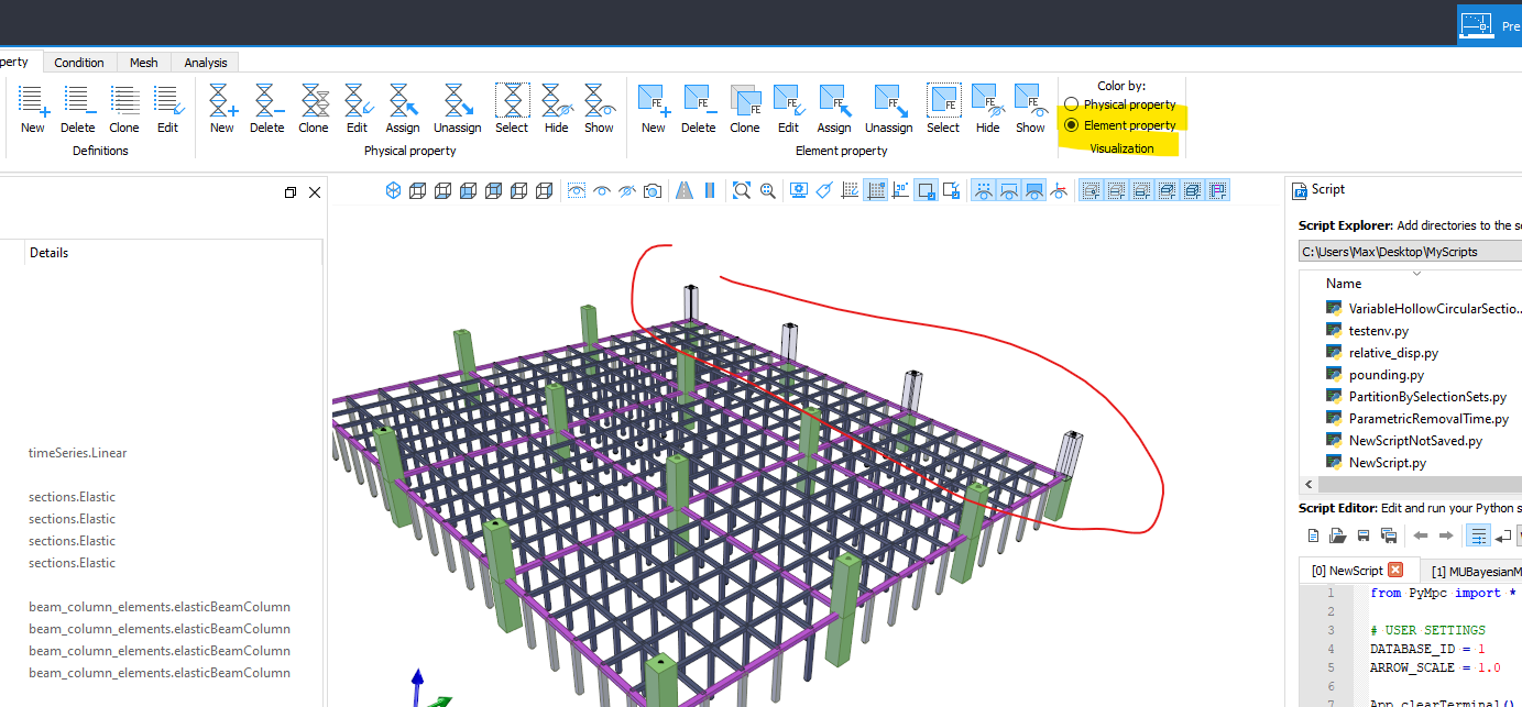

You forgot to assign the beam Element Property to some column,
so STKO will not generate and element for those edges and the top nodes will be hanging, leading to the singularity in your stiffness matrix
