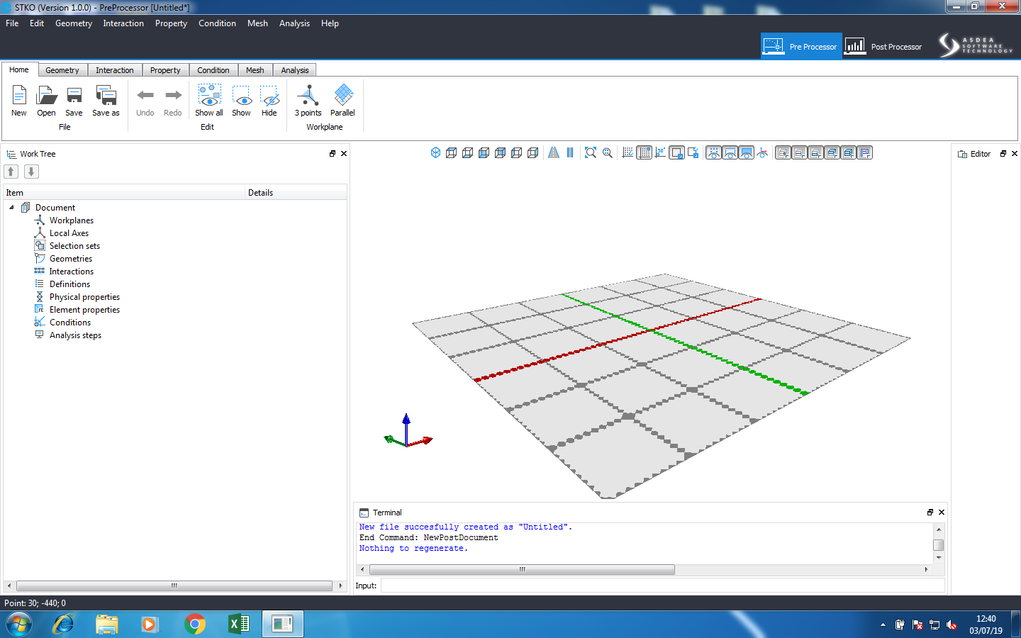

Hello!
I have some visualization issues after I launch STKO (see the pic).
How can I fix it
How can I fix it
- STKO_screen.png (172.42 KiB) Viewed 14619 times

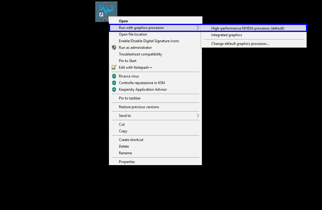

Maybe you installed STKO on a computer with power-saving mode. For example: NVIDIA optimus or equivalent. With a dedicated graphics processor, you can fix your visualization issues in two ways:
1. Right-click on the STKO icon and select Run with graphics processor -> High-performance NVIDIA processor (default).

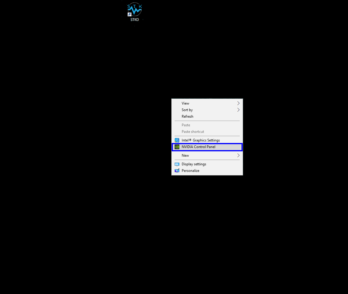

2. Right-click on the desktop and run NVIDIA Control Panel -> Manage 3D settings -> ADD -> STKO.exe -> Add Selected Program -> Apply.
Finally launch STKO. The issues should be fixed!
