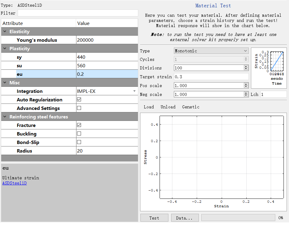

Thank you for replying! When I test this constitutive model, a problem appeared in the material testing interface.
屏幕截图 2026-01-13 194331.png (42.25 KiB) Viewed 224 times
Accompanied by this error message:

Re: Rebar constitutive model including softening segments
Post by STKO Team » Thu Jan 22, 2026 8:59 am
You should read the full OpenSees error in the STKO's terminal.
However, I'm pretty sure you have an old version of OpenSees that does not have this new material model
