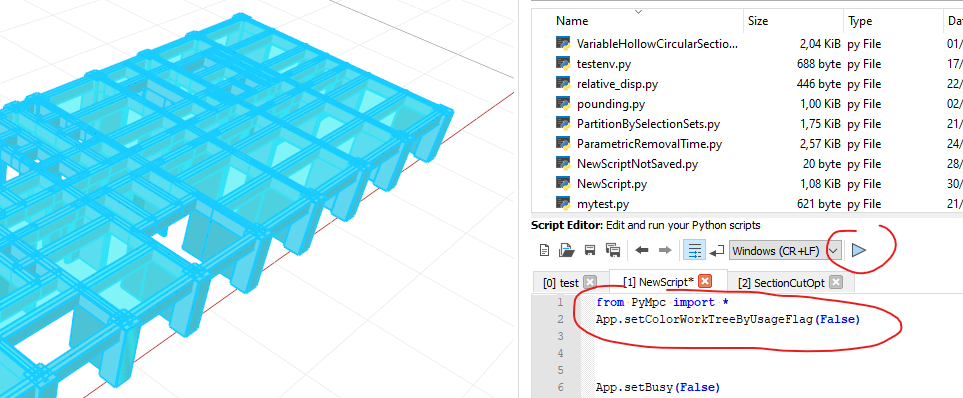

The issue comes from the automatic coloring of the WorkTree items by their usage. When you have thousands of properties (especially with fiber section) it can slow down performance.
Next version of STKO will have this fixed automatically, but in the meantime you can switch it off at the application level (i.e. you need to do it everytime you open STKO as this flag will be reset) by running this simple script:
from PyMpc import *
App.setColorWorkTreeByUsageFlag(False)
tree color usage.png (188.46 KiB) Viewed 237 times
