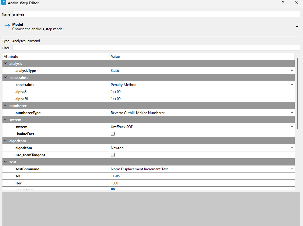

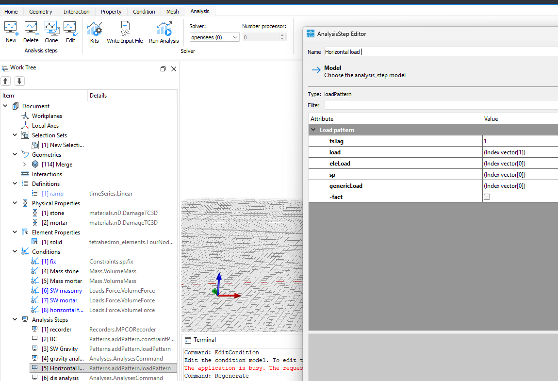

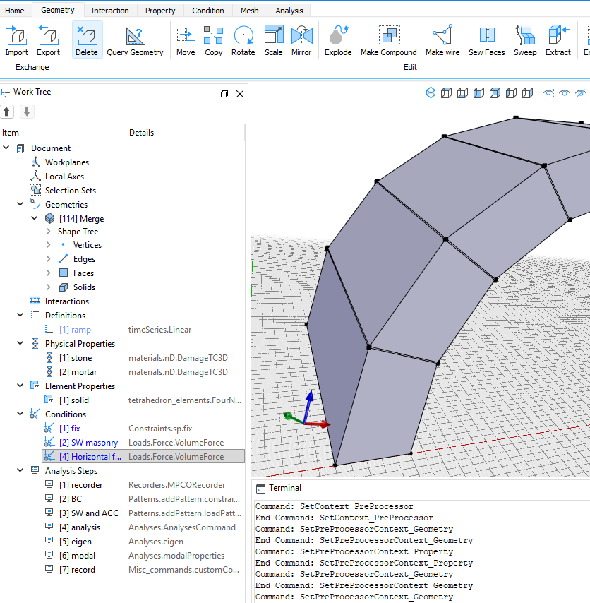

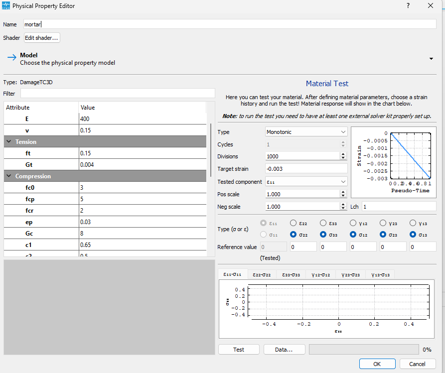

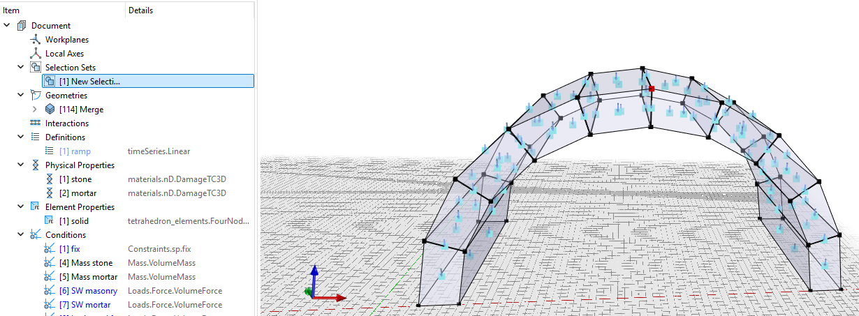

I'm trying do simplified micro model of an arch barrel with 10mm mortar thickness and the dimensions of the model are in mm. I'm interested to see stresses and strains and also wants to do eigen value analysis

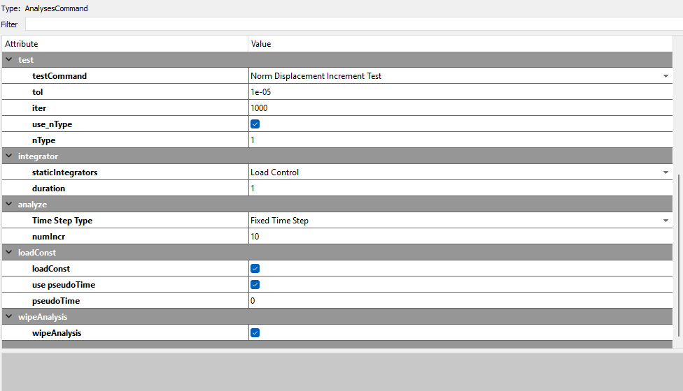

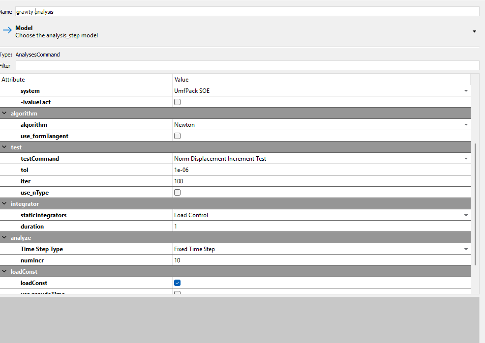

. When i do the analysis
Screenshot 2025-10-01 173932.png (27.58 KiB) Viewed 901 times
Screenshot 2025-10-01 174608.png (15.92 KiB) Viewed 901 times
Screenshot 2025-10-01 173949.png (19.91 KiB) Viewed 901 times
i'm getting this error
WARNING: CTestNormDispIncr::test() - failed to converge
after: 1000 iterations current Norm: 0.0149585 (max: 1e-05, Norm deltaR: 0.518285)
NewtonRaphson::solveCurrentStep() -the ConvergenceTest object failed in test()
StaticAnalysis::analyze() - the Algorithm failed at step: 0 with domain at load factor 0.7
ERROR: the analysis did not converge

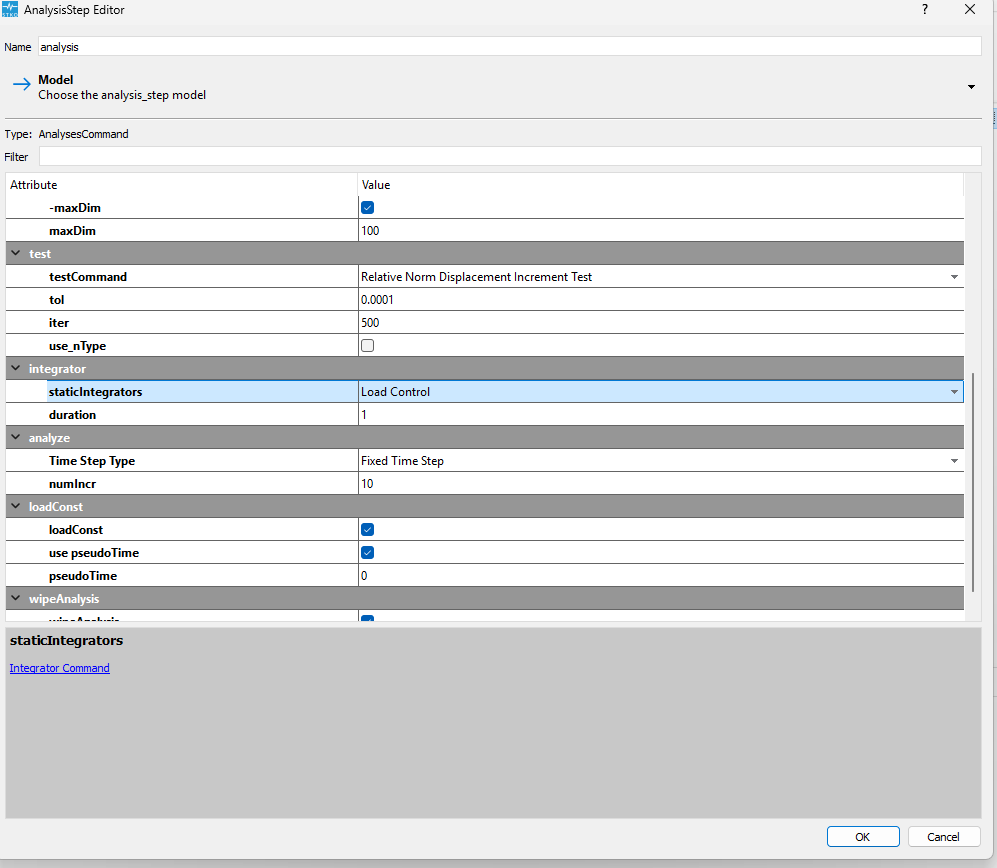

AND WHEN I TRY TO CHANGE THE TEST COMMAND TYPE TO RELATIVE NORM UNBALANCE TEST
Screenshot 2025-10-01 174530.png (21.25 KiB) Viewed 901 times

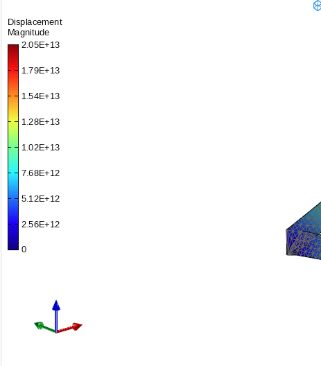

I'M GETTING THIS ERROR MPCORecorder Error: cannot flush file on record()
Increment: 9 | Iterations: 2 | Norm: 7.894e+12 | Progress: 90.000 %
Increment: 10 | Iterations: 2 | Norm: 1.781e+13 | Progress: 100.000 %
Target time has been reached. Current time = 0.9999999999999999
SUCCESS.
ArpackSolver::Error with _saupd info = -9
Starting vector is zero.
WARNING DirectIntegrationAnalysis::eigen() - EigenSOE failed in solve() and i'm getting weird results

Re: Reg! Error analysis did not converge
Post by STKO Team » Mon Oct 06, 2025 7:45 am
This is a simple non convergence error, cannot say much about it without a model
This is really bad! you are accepting an error of 7e12 units of forces!
This typically means you forgot masses

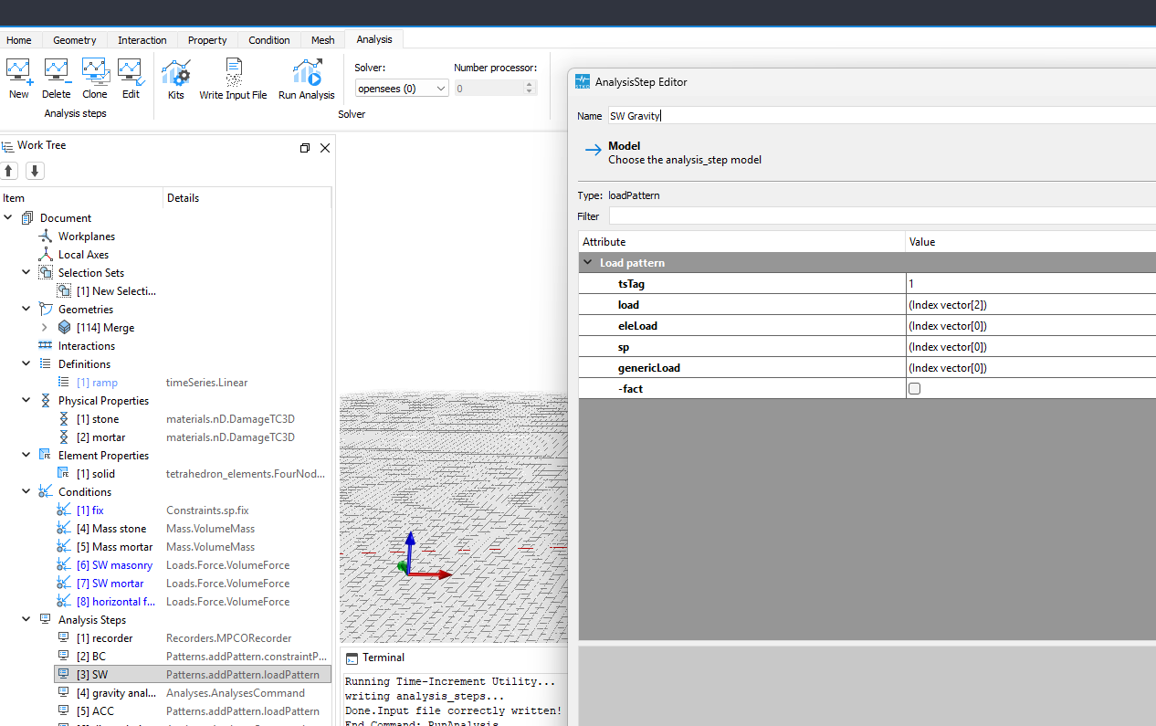

# MODAL ANALYSIS REPORT and the results are also weird.

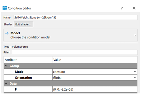

Don't you think your mass density is wrong?
How did you calculate it?
SW = 2.5e-5 N/mm^2
rho = about 2.5e-9! g = 9810 if you are modeling in mm!
Also, don't put the horizontal load in the gravity stage (which is load controlled), DO a displacement control analsys for that
SW = 2.5e-5 N/mm^2
- - W=22kN/m^3 converted to mm

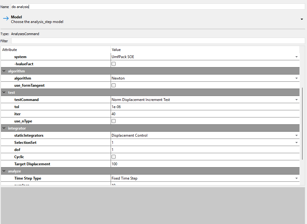

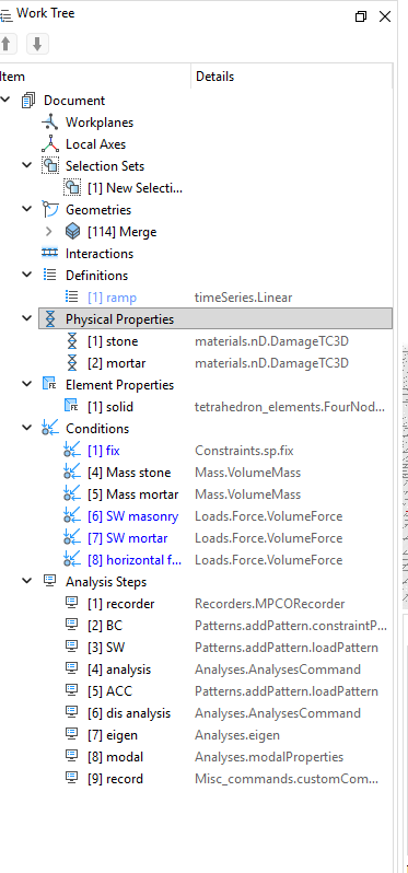

Did you mean i have to use Displacement control integrator: define selection set and give the dof's and target displacements
Screenshot 2025-10-07 141054.png (32.19 KiB) Viewed 570 times
? and
why can't i apply the horizontal force as volume force on each solid as i did it in my above model?

when i did displacement control analysis for the above i got this error Target time has been reached. Current time = 0.9999999999999999
SUCCESS.
TOTAL DURATION: 1.0
CYCLE 1 : nsteps = 10; dU = 10.0; dT = 0.1
Increment: 1 | Iterations: 1 | Norm: 3.983e-11 | Progress: 10.000 %
after: 40 iterations current Norm: 1.16655 (max: 1e-06, Norm deltaR: 671549)
StaticAnalysis::analyze() - the Algorithm failed at step: 0 with domain at load factor 86.8557

This one means that the previous analysis was fine
This one instead is a convergence error. The second time step did not converge.
Can you try using adaptive time step?
