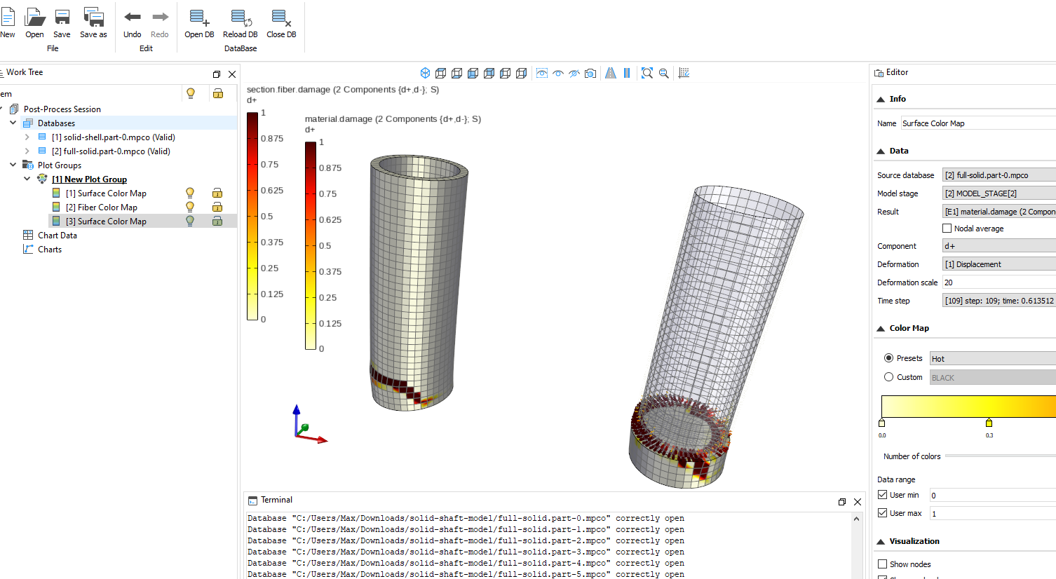

Here are 2 models, one for full solid, and one for solid shell. You can see the way I applied the interaction. Note: that interaction requires a penalty constraint handler. I use the Auto handler (recently developed by us to automate the calculation of penalty coefficients)However, I still have not found good solutions to the other questions I raised previously and would be grateful for your further assistance.
Regarding the error about the ASDConcrete3D, make sure to have the latest version of OpenSees.
