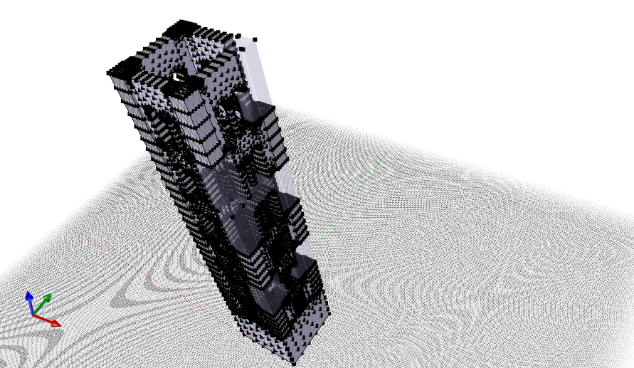

I created a model of a tower, I tried to mesh without merging all the solid elements and I achieved a good mesh but then I tried to mesh everything after merging all into one element and some parts of the tower don't mesh as seen in the image. I'm not sure how to solve this issue.
Thank you!

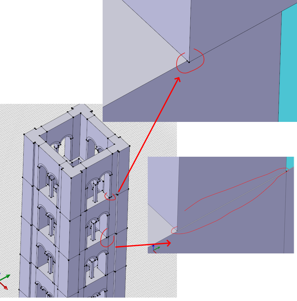

Unfortunately if you merge imprecise geometries you will end up having very small features:
small features.png (298.67 KiB) Viewed 2142 times
So you either make the geometry more precise to avoid those small intersections, or you have to use a very very fine mesh!
