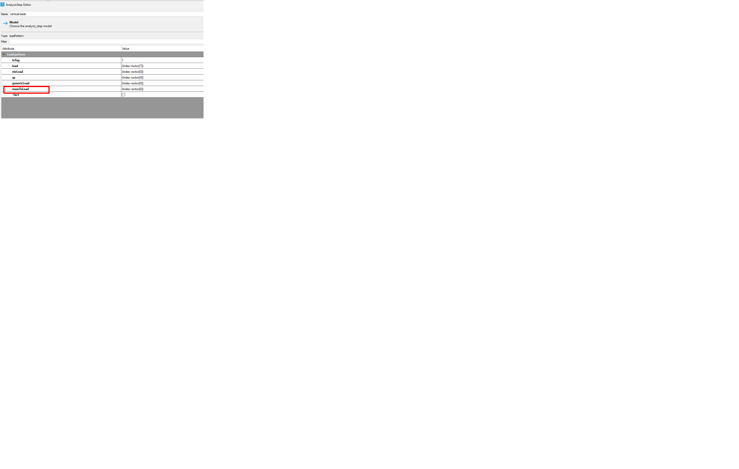

What about the load pattern named "massToLoad"? Maybe it's not a command but it does exist. How it works?
- mass to load.png (47.78 KiB) Viewed 2316 times
Re: How to apply masses in a N-mm-s unit system - STKO
It's an automation we make in STKO to simplify generation of mass and self weight for frame elements.
Problem:
In OpenSees, frame elements do not automatically get the mass density from the material. Therefore the user has to specify, for each element, the mass-per-unit-length (i.e. mass density * cross-section-area) either in the Element Property, or in the Mass->EdgeMass.
If you have a model with a lot of different cross sections, this can be tedious.
Solution:
We implemented a Condition->Mass->AutoEdgeMass, where you can specify the mass density (rho) and assign this condition to all frame elements with the same mass density. This automation will automatically process all elements and their cross-section to compute edge_mass = rho * section_area.
Optionally:
You can also check the "Convert to load" checkbox in the Condition->Mass->AutoEdgeMass, and add this in the load pattern under the option you mentioned
