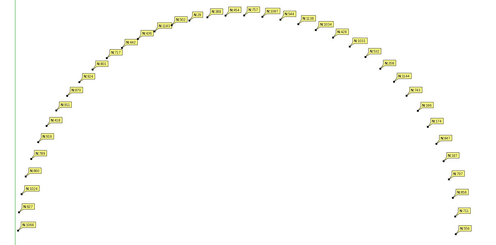

I am running modal analysis of a model to which I gradually introduce geometrical alterations to analyze their influence on the frequencies and mode shapes. I have created a selection set with the nodes that I use to record the eigen vectors, and by using the Labels visualization tool I find the node IDs manually. However, with every alteration in the geometry, the mesh changes and so does the IDs of the nodes and I have to repeat the process for each model.
Is there any script that I could use to query the node ID based on their coordinates?

Thank you for your reply.
I need it in pre-processor.
I have a micromodel of an arch like this:
and I have a set of nodes where I want to record the eigen vectors:
through this script:

Then I gradually remove some joints to simulate a crack opening:
and I want to run the modal analysis again and compare the results recorded over the same nodes with the original model. However, with every removed joint, I have to remesh, so the numbering of the nodes changes, and I have to repeat the process of finding the Node IDs for each model.
So my question was if there is a smarter way to do it, for example, to query the Node ID based on the x,y,z coordinates of the nodes, as those don't change.
Thank you again,
Viktoria

The easiest way is to:
  • create a selection set with the nodes you want
  • create a region analysisStep, and in the region you can tell STKO to generate a tcl list, give it a name
  • In your tcl script you can now reference that list
Re: how to query node ID through its coordinates
Posted: Mon Jun 09, 2025 6:48 am
by VHrb
It works, thank you very much for your help
