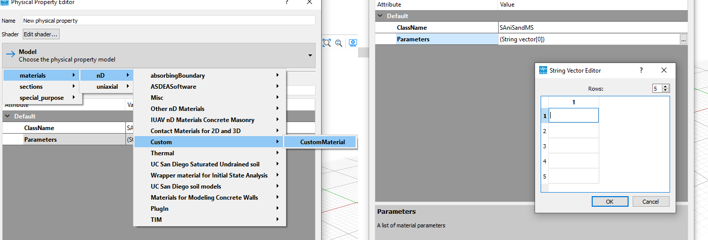

I am currently working on the dynamic response of piles in sand and need to use the SANISAND-MS model (nDMaterial SAniSandMS) developed by Liu et al. (2019). However, I have not found the nDmaterial command for this constitutive model in STKO. Is there a way to assign this material to a soil model?
Thank you in advance for the assistance,
Federico
Re: How to assign SANISAND-MS Model in STKO
Post by STKO Team » Mon Mar 10, 2025 10:29 am
Dear user,
We will implement it in STKO in the next versions.
In the meantime, when a material model is not directly available in STKO you can use the custom nDMaterial interface:
