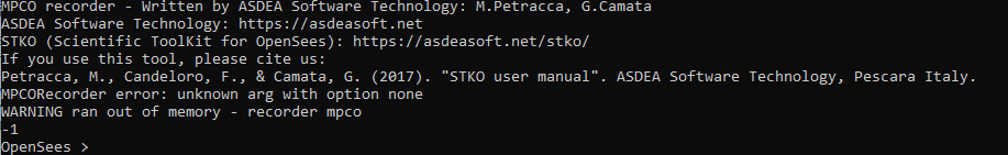

I am using STKO for post-processing in my current analysis. I have created a TCL script that feeds OpenSees and loops through different values of permeability (k) for the same model. This model analysis consists of four stages, with the first stage being a gravity stage. Additionally, I have attempted to create an MPCO recorder using the specified format.
recorder mpco "C:/OpenSees-Solvers/B24F_LE_E2e8_k_${kperm}/B24F_LE_E2e8_k_${kperm}_recorders1.mpco" \
-N "displacement" "velocity" "acceleration" "reactionForce" "reactionForceIncludingInertia" "pressure" \
-E "force" "deformation" "localForce" "equivalentPlasticStrain" \
-E "strain" "stress" "tangent"
While attempting to create the recorders (before the gravity stage), I'm faced with this error:
Screenshot 2025-02-23 211026.png (16.15 KiB) Viewed 2438 times
Could you please provide advice on how to resolve this error?
Best regards,
Ryan

Post by STKO Team » Mon Feb 24, 2025 9:06 am
This is strange. That error should never happen.
Can you print your kperm value? are you sure there is no white space in it?

Post by ryancwl95 » Mon Feb 24, 2025 8:34 pm
Could you explain what you mean by "white space"?

Post by kesavapraba » Mon Mar 10, 2025 7:37 am
Hi, I think STKO Team meant any spacing in the kperm string. For example, if your kperm is "Hi there", you can notice the space between Hi and there.
