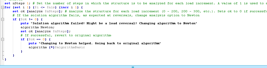

I just one more question, is there any way I can provide input of an adaptive analysis method like this? (other than sourcing the tcl file as a custom command in the analyses)
Herein I am asking the script to change the algorithm to say Newton if it hits convergence issues and then switch back to the original stated algorithm.
Thanks again!!

In the current version you can't. However right now we are implementing adaptive time step directly in the analysis command, where the user can choose:
  1. fixed number of increments (the default for OpenSEES)
  2. adaptive time step based on convergence properties (i.e. changing the time step size)
  3. adaptive algorithm
I will let you know when this new feature will be available.
