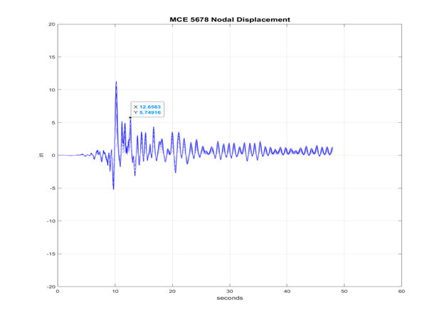

Thank you for the reply. I am a little confused. The nodal displacements come from a time-history analysis of seismic motion. This would be a classic time-history analysis, except that instead of a unique ground acceleration at each of 8000 steps, we have unique nodal displacements at each step. (See attached png file). So, using a multiplier like Lambda, I would need 14 different Lambdas (one for each displaced node), but also the Lambdas would change for each step...
Nodal Disp.png (31.86 KiB) Viewed 2880 times
Isn't there a way to load in a list of displacmenets for each node at each step? Or, if I am completely misunderstanding your response, could you please possibly include an example file for me to model from?

You need to understand how opensees works with loads/sp:
Imagine the case in which Node01 is subjected to the following time-displacement pattern:
t=[0.0, 0.5, 1.0], u=[0.0, 10.0, 0.0] (a triangular pattern with peak displacement = 10.0 units)
  • Define a Defintions->timeSeries->PathSeries with the previously mentioned vectors (times, and loadMultipliers)
  • In condition you define the reference SP for Node01 (set it to 1.0, because the loadMultipliers already contain the actual values for displacements)
  • In AnalysisSteps->loadPattern-> add the condition (sp) and the timeSeries
Repeat for all nodes.
Alternatively you can use Tcl scripting to make it more automatic, like programmatically load those values from text files.
But it required programming capabilities
