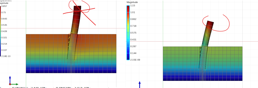

Please see attached powerpoint clearly outlining some questions I have. The Models are also attached.
Thank you in advance
Re: Force-Displacement
Posted: Wed Feb 19, 2025 10:13 am
In your models you have different results because you are comparing different things
  • In one model the soil is elastic, in the other id DP (though this is not the main source of difference).
  • In the model where you apply displacements in UY, you are also fixing Uz to 0! this imposes a different displacement pattern to the pile (and a stiffer response... shear beam vs cantilever)
  • Please, always check displacements to understand the behavior of your model! don't look just at Force-Displacement graphs
  • In the applied force, when you monitor the reactions, make sure to monitor all the faces where you have a fix in UY.
  • Also in the 2 models you are monitoring different points for displacements... of course if you monitor the average of the soil hole, you will see a smaller displacement because, due to contact, the back nodes of the soil will move less (separation from pile, again look at the displacement to understand this point)
Summary
The correct model is the one with applied displacement in Uy (but you have to remove the applied displacement Uz=0, otherwise your beam cannot rotate as a cantilever).
