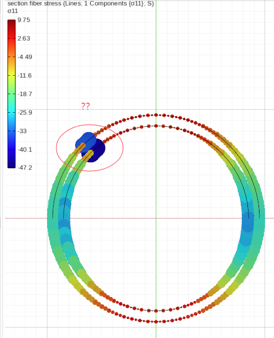

THANKS! I think I already know how to show the stresses , but what I show is the figure below,It's not clear to me why there is such points?

If you isolate the inner solid and plot a (very) deformed shape you will see that you have a gap in your geometry
Re: beam_solid_bar_slip
It's amazing, thank you.
