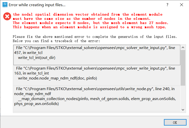

I'm trying to use STKO to simulate a pull-out test of a grouting sleeve, and I had built a simple model, but ran into some issues.
1. The following issue occurs when running,I don't actually know why this happen.

Did you read the error message (the bold red one)?
yeah, I understand it literally,but I don't know how to fix it.
ok,I finally find out what's wrong, sorry for bothering.

Post by STKO Team » Wed Dec 11, 2024 9:55 am
The element property requires an hexa mesh with 8 nodes, but you assigned this property to a mesh made with 27 nodes.
Just assign a mesh control to the solids set to Quad/Hexa - Structured - Linear
