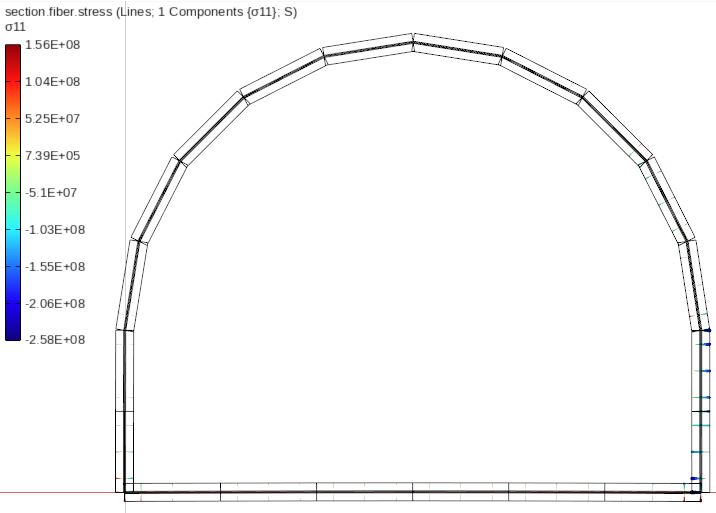

Hi STKO,
I want to get the color stress map of the fiber section (tunnel) as in the attached file. However, the colored dot is so small, I can not see the color map of the whole tunnel.
Can you please suggest any solution for this?
Thank and best regards,
Buu
color map.JPG (33.14 KiB) Viewed 2920 times

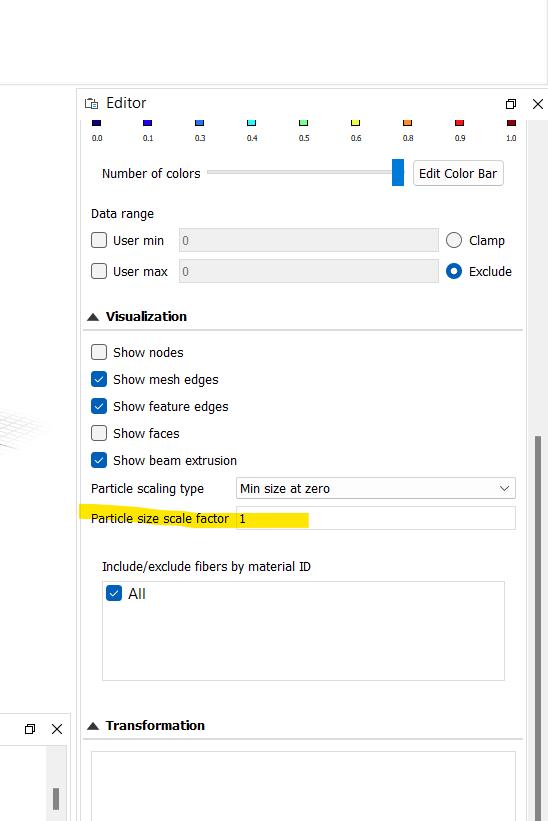

Post by kesavapraba » Tue Oct 29, 2024 7:47 am
Hi, Please use particle size factor, in your case: increase it.
