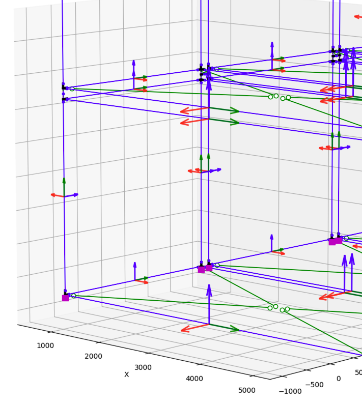

The orientation of the beam in Global X and Global Y is made using the following commands:
op.geomTransf(BTransfType, BTransfTagX, 0, -1, 0, "-jntOffset", *dI, *dJ)# local z-axis is in the negative global Y-axis
op.geomTransf(BTransfType, BTransfTagY, 1, 0, 0, "-jntOffset", *dI, *dJ)# local z-axis is in the positive global X-axis
and when I plot the local axes they seem to be right as shown here:

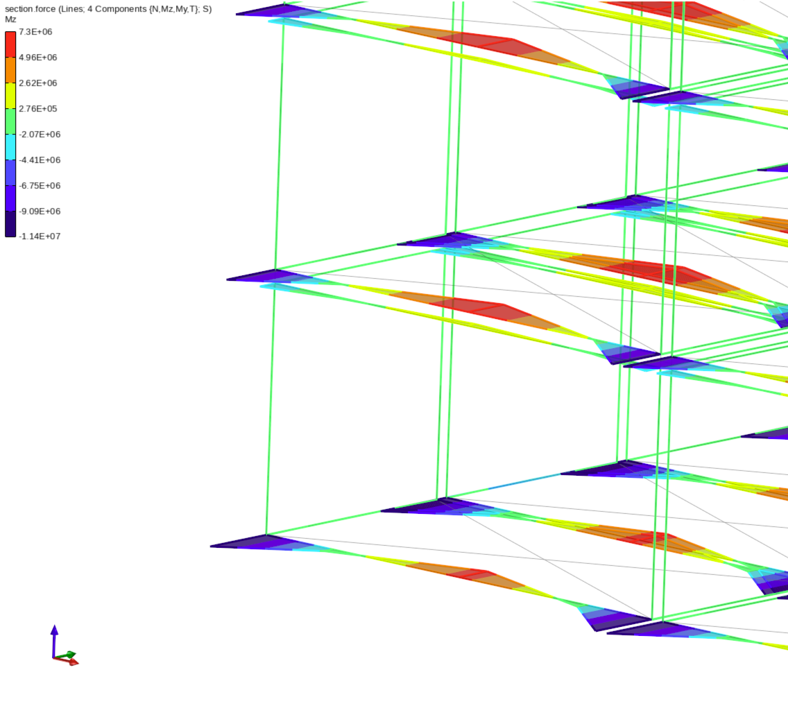

No when I run the model and open the .mpco file and create a beam diagram plot. The results of the section.force Mz is as shown here:
Screenshot 2024-09-16 at 9.02.13 PM.png (432.92 KiB) Viewed 3234 times
Shouldn't the Mz be the moment around the local z axis? so the diagram should be plot in the X-Z plane not the X-Y plane?

Hi, the script seems to be fine, however the directions (in RGB Red, Green, Blue) in the first figure is not aligned with what is shown in STKO coordinate systems. For example, the local-x axis (red) should be oriented along the length of the beam, this is not correct in your first figure.

The axes shown in the first figure are the local axes while the axes shown in stko are the global axes.
If the red is the X-axis in stko and the green is Y-axis then the global axes match between opensees and stko as shown bellow:

It's probably because you did not create the model in STKO pre processor.
Local axes are not obtained as an output from Opensees (they are not available for all elements), so we use STKO to generate a support file for the mpco recorderer, with the extension .mpco.cdata.
It contains several information not available from opensees recorder such as local axes and section extrusions
