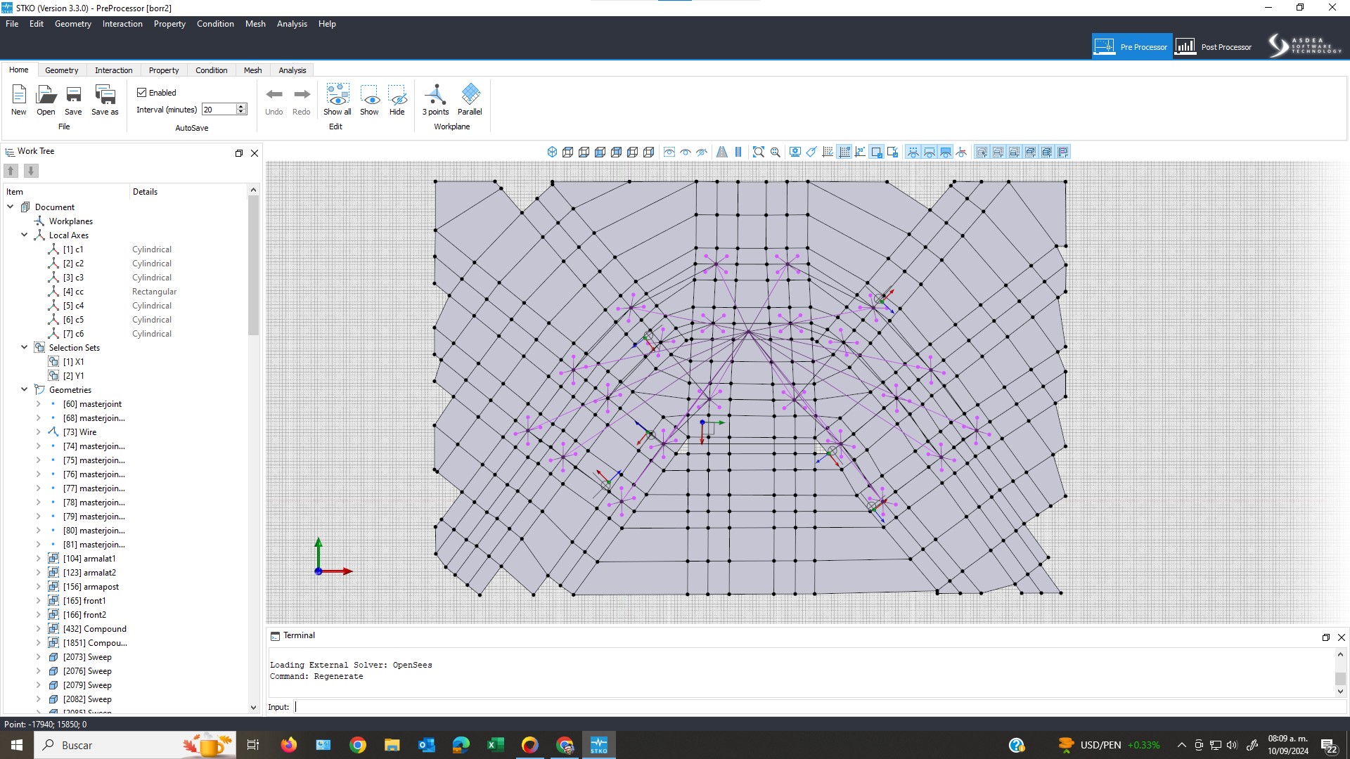

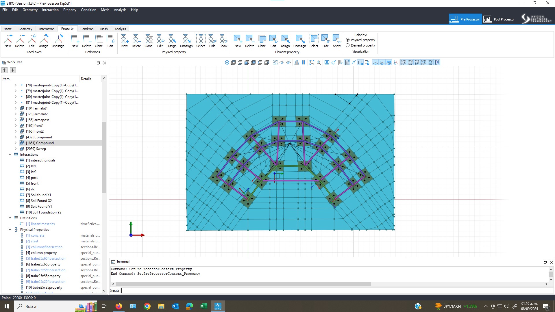

I have a semi-circular and linear disposition foundation. In order to model the soil, I draw each solid to fill the space between the foundation, but I have triangular solids.
I assigned the element properties of the soil as SSP Brick, like in the online tutorial ASDA Absorbing Boundary Conditions. As the brick element is an eight node hexahedron. I erase the triangular solid and mesh the solids with structure hexaedron linear to see if it runs, but the error keeps saying: Invalid type of element or number of nodes, and I will have at the end triangular solids (I left them in blank in these models)What do you suggest to make run this model considering the interaction of the soil? Do I have to change the element properties to another? Do I have to do the mesh in a different shape?

I remesh again with 6 faces elements, so I can still use Blocks. (photo 1)

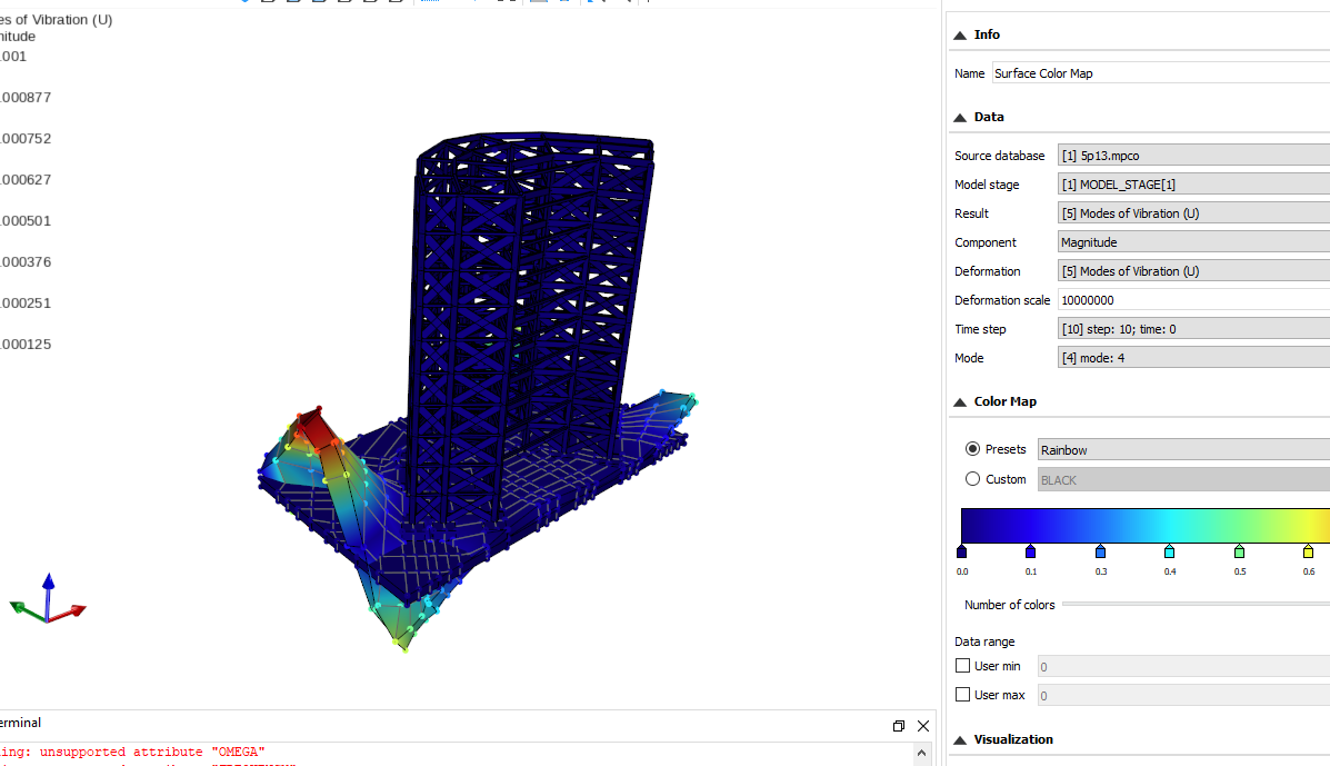

Now, when I merged this mesh followed by the command "Build the mesh", many soilds disapear and ther turn ligh gray, showing only the nodes. (photo 2)
When I used compound, they all keep together, but to have the soil interaction effect, I need to merged them, righ?
Can you help me, what I am making wrong?

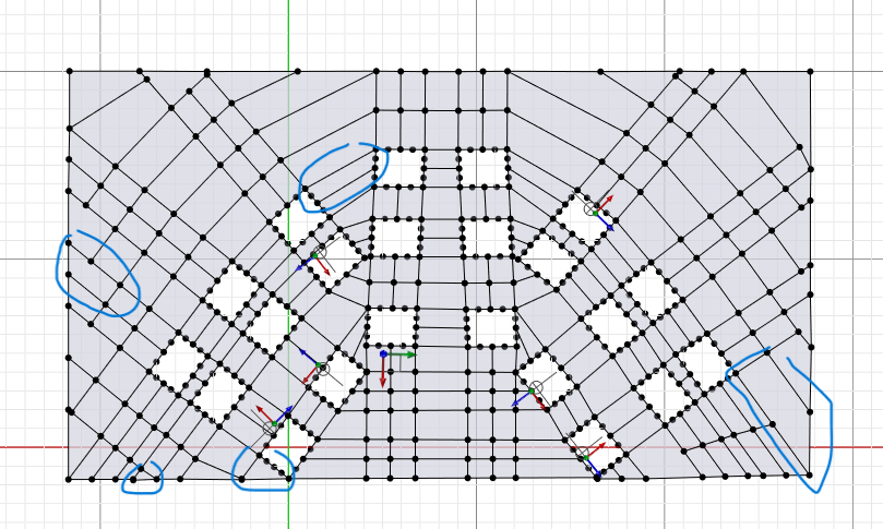

Sorry but looking at picture1 I can see many volumes that are not 6-faces (top-bottom-front-back-left-right):

If you plot the modes of vibration you will realize what's going on:
- modes.png (205 KiB) Viewed 3011 times
Your soil layers are not attached to each other.
