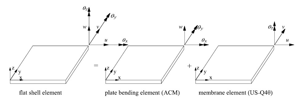

Hi. Sorry to get back on the topic, but there is one thing I wanted to ask you.
Is it correct that the membrane part of the AGQ6-I acts on 3 translations? (1,23,)? and not 2 translations in plane ULX, ULY (1,2) and the rotation RLZ?
Summary AGQ6-I acts on (1,2,6) DOFs
and MITC4 ULZ and RLX,RLY (3,4,5) DOFs ?
I found something like this in one reference:
I have written that the local stiffness matrix of ASDSHELLQ4 can be represented as:
but I have assigned driling deegre to mitC4
Is this notation in this case correct?
Re: ASDShellQ4 stiffness matrix
Post by STKO Team » Tue Oct 29, 2024 9:34 am
The AGQ6-I is the membrane part that acts on the first 3 DOFs in local coordinates (1,2,3).
The MITC4 is the plate part that acts on the last 3 DOFs in local coordinates (4,5,6).
Yes sorry, there was a typo here.
Membrane = Ux(1) Uy(2) and optionally Rz(6, the drilling DOF)
Bending = Uz(3) Rx(4) Ry(5)
