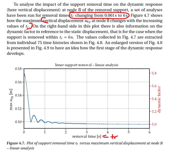

For each support removal time I need to extract the maximum value of vertical deflection and make a chart . For example for Tr=0.001 s (uz= 0.05m)for TR=1s (uz = 0.1m) and make a graph as in the attached picture:
Are you able to help me modify the previous py file. so that it additionally parametrically selects the maximum deflection value for each tr value from previous analyses?
Selecting a maximum value of delfection from each analysis and creating manual graphs for a large number of different tr support removal times will be very time-consuming. :(

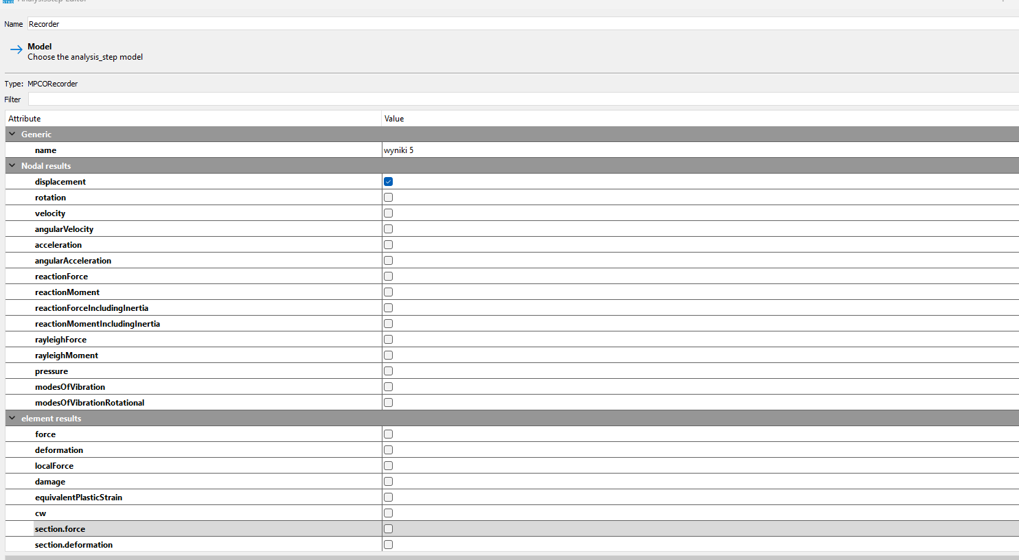

2. I selected only node displacements in the recorder because the previous mpco files were 150 mb each.
mpco recorder.png (34.53 KiB) Viewed 1919 times

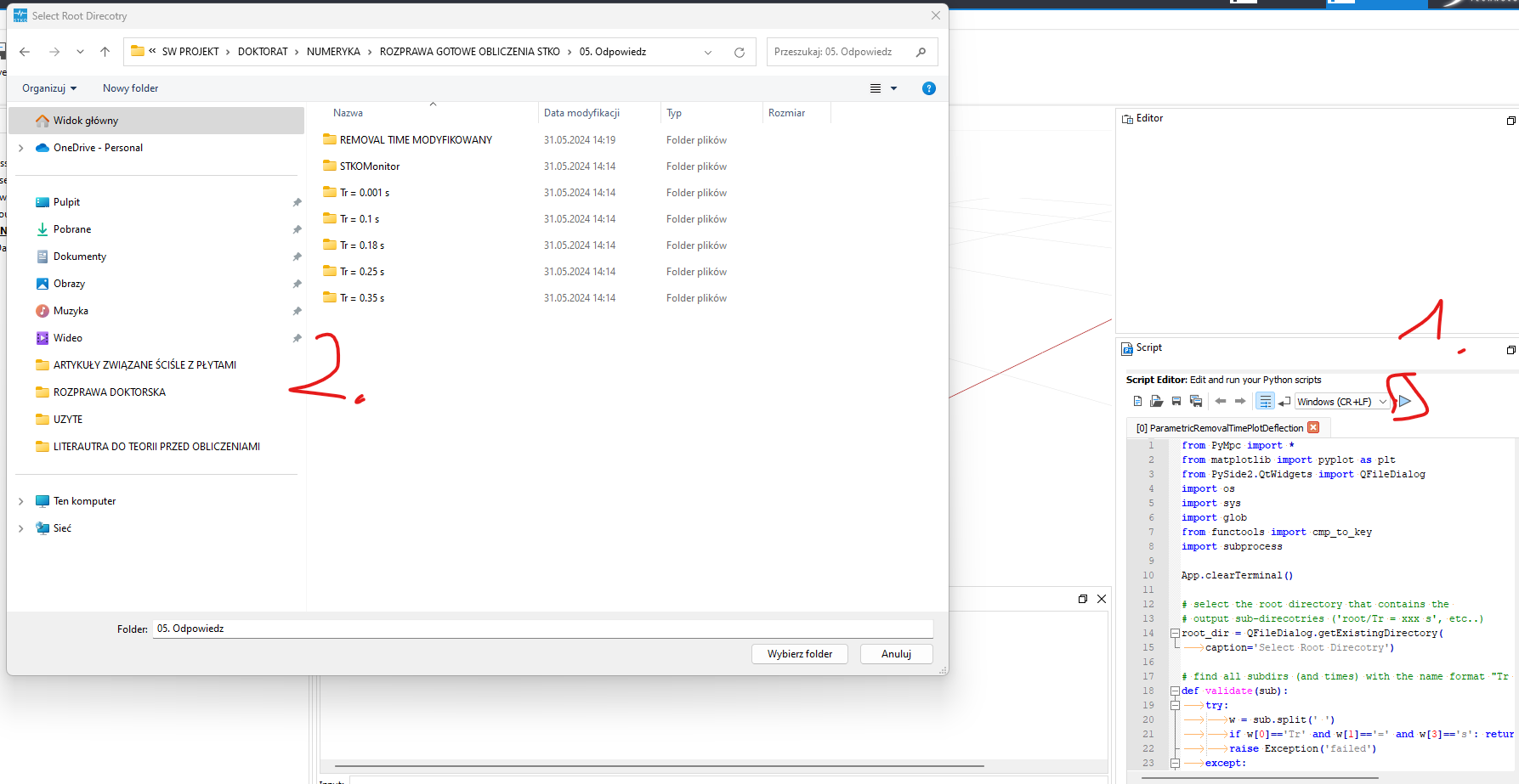

3. i opened the post processor
4. I copied the PY scripts you received into the main folder.
5. launching the anlysis the program asks me to select a folder. I chose the folder where all the folders with tr times are.
post procesor.png (128.44 KiB) Viewed 1919 times
6. I received a graph in a straight line and zero uz value.
